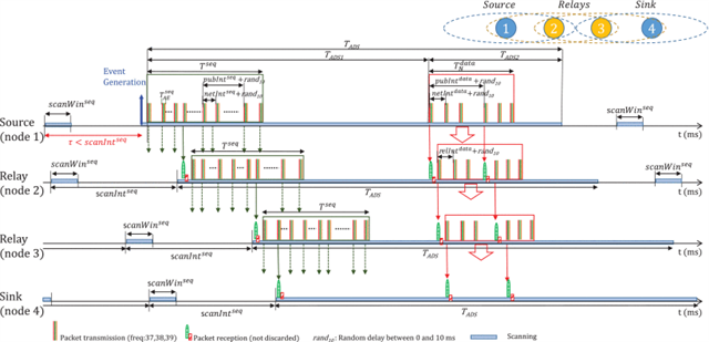

  • My goal was to implement BMADS which is a flooding adv network using dynamic scanning only when there's data to send through mesh. It usually scans intermittently and when there's data to be sent, it switches to simultaneous adv and extended scanning mode and push other nodes to do longer scanning to receive the data.
    I had a look on nordic library and tried some things. I reached a conclusion it can't be done unless I have a control over softdevice or hardware is not designed for it.
    BLE cannot simultaneously scan and advertise so the device has to switch immediately between two modes. But this is blocked in the Nordic SDK or zephyr or mbed OS, etc.
