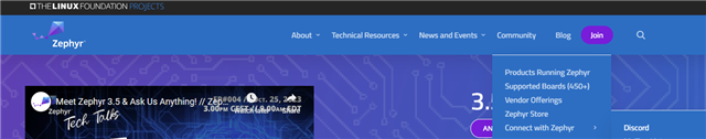

    Regarding how to get this up on a cloud you will have to think about what cloud you're aiming to use and what communication you aim to use. Unless you will be using nRF Cloud, we have limited resources available for how to do this, but you might find some inspiration or other developers who have done so on the Zephyr discord forum. See the community tab at https://www.zephyrproject.org/# for a link to the discord
