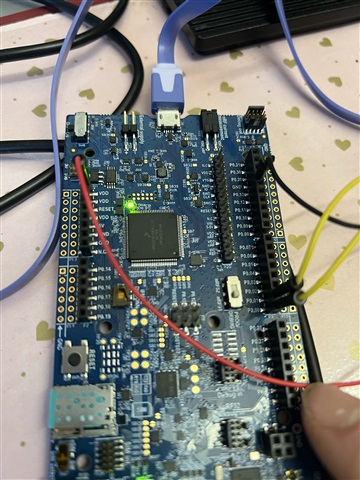

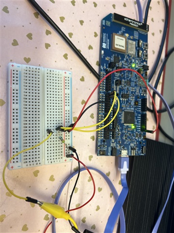

  • Hi Sigurd
    We have tried to port the DS18B20 1-Wire Temperature Sensor to the nRF9160DK, but we do not receive any response from the sensor. Is it possible to have a meeting to discuss this? Br Mikal

    No, we generally do not provide meetings. If you are insistent on this, you can contact our sales departement, and they might be able to arrange something.
    Instead, we prefer to give debugging tips over this forum.
    Such as:

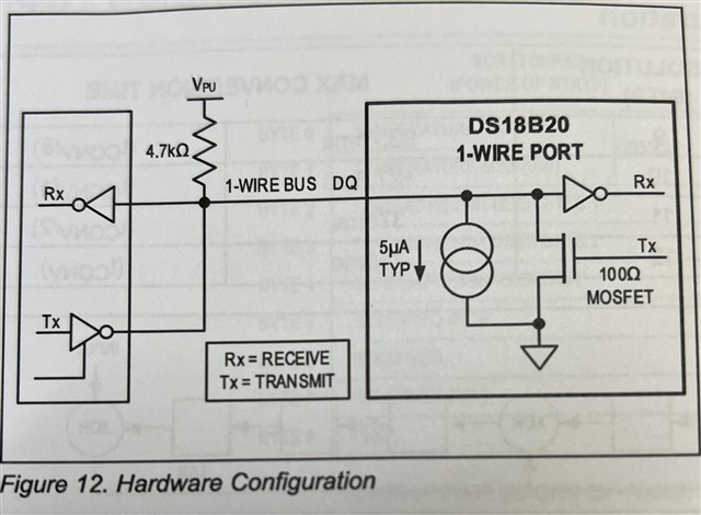

    Can you connect a oscilloscope or logic analyzer to the data line(s) and see if you see any communication on it?
    How did you wire your sensor?

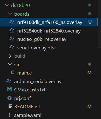

  • I just copied the nrf52840dk overlay file to a nrf9160dk overlay file without changing anyting but the name.
    Can I just remove the nrf52840 and the nucleo files?
    Why are there both an serial_overlay.dtsi and a arduino_serial.overlay file when they look alike. Since I am using an external sensor is one of them obsolite?

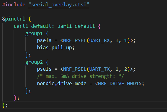

    This is my overlay file:
    Does the code: NRF_PSEL(UART_RX, 1, 1) refer to UART1.
    Should I use UART0 to use pin P0.00 and P0.01?
    br Mikal
    Yep, only used if you build for boards with same name as overlay file.

    These overlay files are not included automatically. They are either included in your CMakeLists.txt or in your build configuration.
    I can not see serial_overlay.dtsi anywhere in https://github.com/nrfconnect/sdk-zephyr/tree/main/samples/sensor/ds18b20, so this must be your custom one right?
    You are setting RX pin to GPIO 1.1. This does not select any UART driver for you. The uart selected is another place in your DTS files, where you refer to the uart1_default pinctrl node.
    The 9160 peripherals can allocate pins as you please, so you can use any UART instance with any pins. Just make sure that the pins match up with the pins you have connected the sensor to on the DK.
