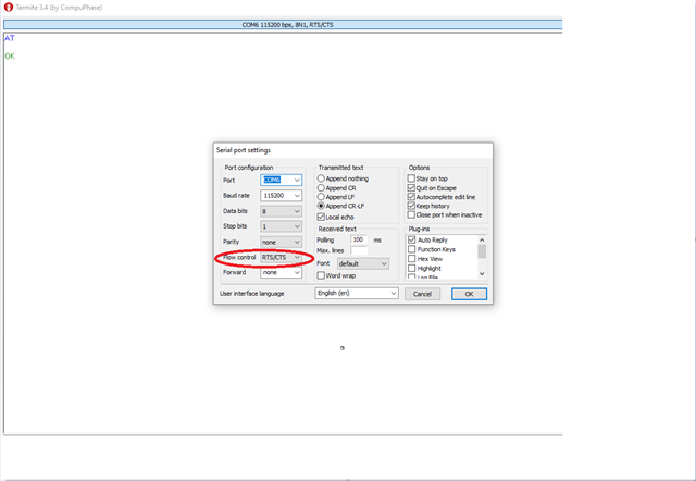

    Question 1

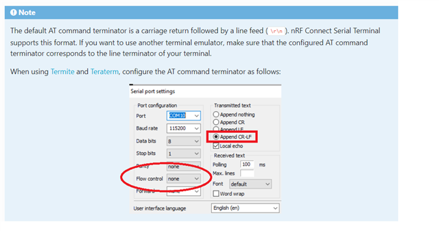

    It does not work on Termite. Perhaps the serial port settings are not correct? I am pretty sure I have configured as suggested on your website:
    developer.nordicsemi.com/.../slm_description.html
    but it still does not work:
    If you have termite, could you please try this on your side just to confirm there is an issue on my side?

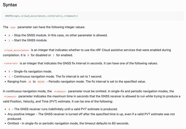

    As you can see from the image above, I have tried to use AT#XGPS command but the ERROR has been returned. Perhaps you got any ideas why would that be the case?
    I use the following example:
    Can you run it on your side just to confirm it works on your side?

    Anyways, regarding the termite, I have been further experimenting with it and discovered that you have to set Flow Control in order to get the response:
    However, on your website this is not shown:
    which is quite misleading.
    Thanks for pointing out! I will inform our documentation team about this.

    Thank you very much for investigating this further! Are you suggesting that there is an issue with the AT#XGPS command on the ncs v2.5.0 or this issue is specific to the serial_LTE application?
    No, sorry, the issue seems to be with the example itself which will be fixed in latest version. The #XGPS command does not have 5 arguments but 4.
    Can you try issuing  AT#XGPS=1,0,0,0 instead?
