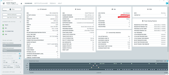

I have flashed the device with asset tracker v2 application and opened cellular monitor:
I was hoping to see the device position here but I do not think that is the case since I cannot see position parameter anywhere

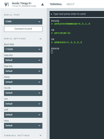

I have also tried this:
https://electronics.stackexchange.com/questions/73427/trying-to-find-location-in-gsm-network
but it did not seem to work.

    Not at all.
    1. Is there a way to get the device location (latitude, longitude) using AT command?
    No, the AT commands does not communicate with the GNSS module. It uses the GNSS interface from the modem library which is shown in our GNSS sample.
    Can you monitor device position in Cellular Monitor?
    The output from this sample is shown in the Serial Terminal which can be opened from the Cellular Monitor.
    The position of the device running Asset Tracker v2 is uploaded to nRF Cloud. More information on this is described in the nRF Cloud documentation.

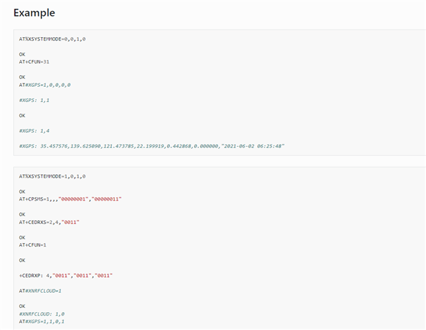

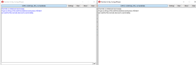

  • Thanks. I have looked at standard and proprietary AT command list:
    https://www.nordicsemi.com/-/media/Software-and-other-downloads/SiP/nRF91x1-SiP/v0.8-nRF91x1_CIoT_and_Positioning-AT-Commands-reference-guide.pdf
    https://developer.nordicsemi.com/nRF_Connect_SDK/doc/2.5.0/nrf/applications/serial_lte_modem/doc/AT_commands_intro.html#slm-at-intro
    I have also flashed the serial LTE modem application on the nRF9160 on Thingy91 while running connectivity_bridge aplication on the nRF52840.
    As expected, it does not seem to work right out of the box.

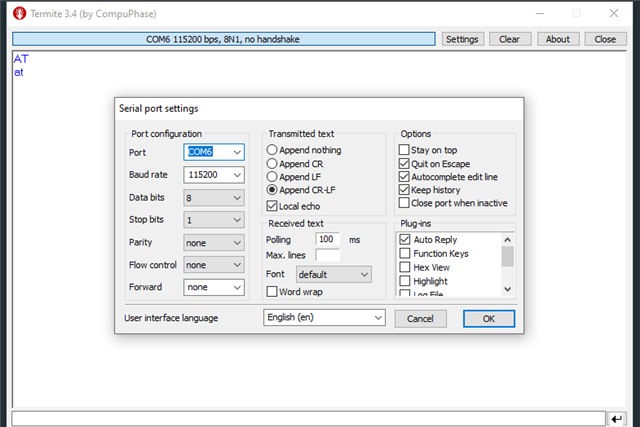

    I have configured Serial terminal (Termite) as shown in the instructions:
    https://developer.nordicsemi.com/nRF_Connect_SDK/doc/latest/nrf/applications/serial_lte_modem/doc/slm_description.html#communicating-with-the-modem-on-thingy-91
    But I cannot see anything being printed on the serial console:

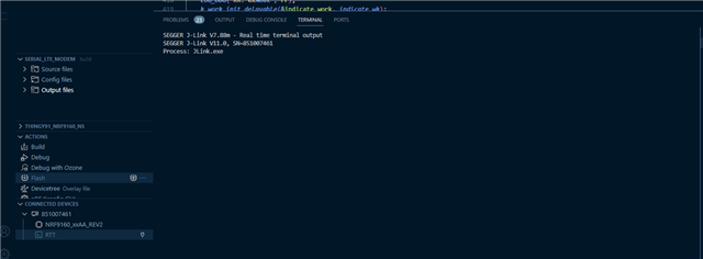

    I have also tried to open RTT terminal but it is also empty.

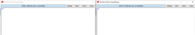

    I have also tried to send some AT commands, but no response

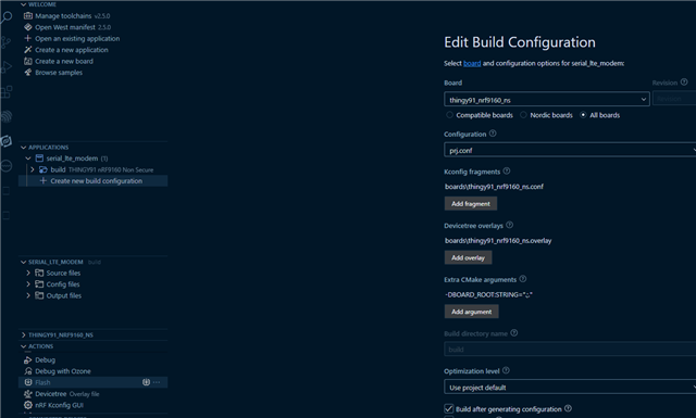

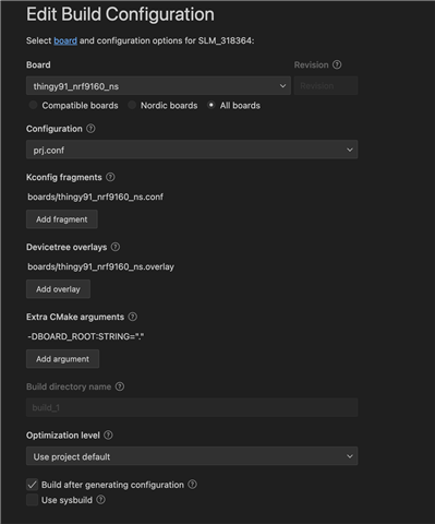

    I have built the project using the following build configuration:
    Considering everything, I believe there might be some issue with the project configuration. Is there a possibility you can try this on your side with ncs v.2.5.0 and check if you see messages being printed to the console with the default project configuration (not changing anything).

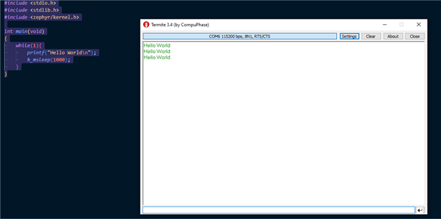

    I can upload a simple hello world program to the nRF9160 such as below:
    #include <stdio.h>
    #include <stdlib.h>
    #include <zephyr/kernel.h>
    	while(1){
    		printf("Hello World\n");
    		k_msleep(1000);
    and I will see the hello world messages on the terminal:
    So that proves that there is no issues on my HW.
  • zazas321 said:
    www.nordicsemi.com/.../quote]
    Note that you are referring to nRF9161/nRF9131 AT Commands Reference guide. This does not work for the nRF9160. The AT Commmand reference guide for nRF9160 is found here.

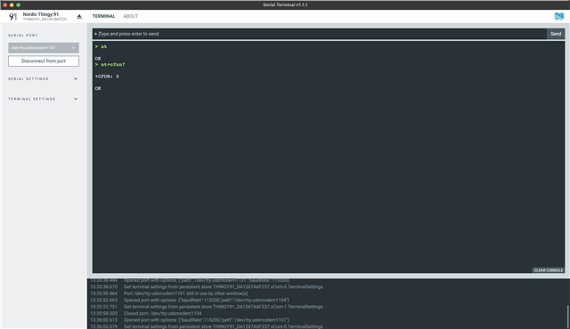

    I tested with the Serial Terminal (found under nRF Connect for Desktop) and did not have any issues with running the application (SLM v2.5.0) on my Thingy:91
    What version of the Connectivity Bridge are you running? How are you programming the device?
