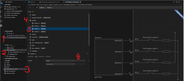

    In the devicetree, or rather an overlay to a device tree, you can configure the pin to be active high.
    1. Build your current project (or something that compiles) for the nRF52840dk
    2. Create a new overlay for the file
    3. Use the Devicetree helper located at the actions tab in VS Code extension
    4. Open the buttons-node
    5. Select the button you want to configure
    6. Set it to active high instead of active low
    You can now see that in the dts you generated in step 2 that the buttons has changed. Every other button than button 2 is active low, while button 2 is active high.
    Recompiling and running your firmware should result in a build where button two is now active high, while the rest is active low.
    Do note, that the Devicetree helper tool might give the wrong output in some cases, so I recommend that you also consult with the documentation regarding configuring devicetree and overlay here https://developer.nordicsemi.com/nRF_Connect_SDK/doc/latest/zephyr/index.html. It is however a tremendously good tool to familiarize yourself with what you can do with nodes and how to change things.
    Let me know if this resolves your issue
    Andreas

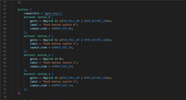

  • Hi Andreas, thank you for the detailed response. Just one question, once I follow the 6 steps, the changes are reflected in the devicetree file itself, not the overlay. Am I doing something wrong here?
  • Yeah, you're right. I was a bit too quick there and assumed that the changes would be added to the overlay directly
    What you can do to not make this change permanent to every future build with that board file to do is to copy said output, i.e the changes that is added to the board file to the overlay file that resides in your project folder. This will ensure that whatever is in the overlay file overwrites the board file configuration for only the projects that uses this overlay file
    Let me know if you're able to resolve it by doing that and if not I'll look more into it! :)
