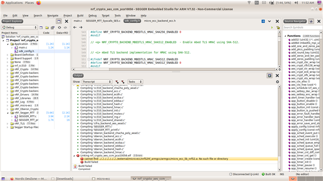

The micro-ecc library is not delivered with the SDK, you need to build it yourself before it can be used in the examples. See Installing micro-ecc for more details.
Note that if micro-ecc is not used in the example, you can remove/exclude the library file from the project. It is found under the "nRF_micro-ecc" directory in the project browser.
