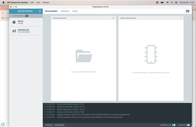

  • Hello - thanks for your help here.
    So to change the parameter as in the discussion thread you C&P above - we need to edit the KCONFIG files.  Can you show the exact change we need to make to which part of the file - this would be helpful - many thanks - Richard
  • Hi Andreas, I'm working with Richard.
    I've added
    CONFIG_BT_MESH_RELAY_BUF_COUNT=256 into the prj.conf file and the messages No free slots" error while sending message have disappeared.
    i also added to the KConfig file the lines below (please let me know if it is completely redundant)
