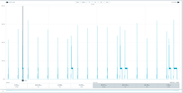

Dear Devzone-Team,
I am working on an nRF7002 based IoT Sensor using the nRF7002DK. I managed to set up the WiFi in STA mode and connect to Raspberry Pi working as AP. The nRF7002 should act as a UDP Client and send data to the AP.  I managed to set up the socket and the communication to the Raspberry is working.
Now the problem:

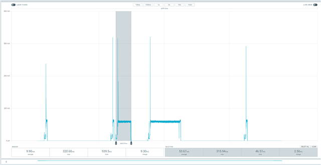

When I look at the measurements with the Power Profiler Kit II there is too much power consumption in my opinion. Without UDP transmissions I have roughly the power consumption mentioned in Operating in power save modes and Target Wake Time on the nRF7002 DK for the normal DTIM Mode.
However, it seems that for the UDP transmissions it takes a long time until the sleep mode is activated again (~60mA for around 150ms). Please look at the attached figure from the PPK2, where you can see the UDP transmissions every 1s. The narrow spikes are the DTIM and the broader ones (~150ms) are when the UDP transmission is started.
Maybe you can help me to reduce the power of the UDP transmissions to the absolute minimum. (Maybe the nRF7002 waits for an response by the AP?)
Here is the main file:

  • Hello Marte,
    Thank you for your answer and sorry for the late response.
    I tried your fix and added the following lines:
    struct wifi_ps_params params = { 0 };
    struct net_if *iface = net_if_get_default();
    long timeout_ms = 0;
    params.timeout_ms = timeout_ms;
    params.type = WIFI_PS_PARAM_TIMEOUT;
    net_mgmt(NET_REQUEST_WIFI_PS, iface, &params, sizeof(params));
    and it seems to sometimes reduce the uptime - but not every time.
    I attached again a picture from the PPK2:
    We can see that for the marked UDP transmission, the up-time is reduced to around 20ms. However, in half of the cases, it seems that the module goes to sleep, and then wakes up (my guess would be to send the NULL-Function because there is a single transmission in the beginning) to then go to sleep again.
    So there might be still a problem somewhere.
    I would have still some open questions:
    1. Is there any way to prevent the module from sending these Null functions or to do it immediately
    2. Even in the cases where it worked, the 20ms up-time is still very high if compared for example to the DTIM messages. It would be nice if the module only is in receiving when there is something planned to receive.
    3. In the UDP example for the nrf91 there is something called RAI to tell the module that there are no further messages - is there something similar for the nrf70
    4. I found another timeout parameter for the kconfig but I have no idea what it does:
    config NRF700X_RPU_PS_IDLE_TIMEOUT_MS
    	int "RPU power save idle timeout in milliseconds"
    	default 10
    Thank you again for your time and I hope we can find a solution for this. Really Low-power UDP transmissions would be a nice feature.
    br
    Julian

  • Hey Marte,
    thanks again for your answer and for being patient with me :-D
    I set up the wifi shell and you are right, the nrf70 stops sending Null functions for wifi ps_timeout 0
    However, I am still confused by the results of my measurements:
    Setup: Wifi shell, network card in monitor mode, PPK2, wifi ps_timeout 0
    I checked what exactly happens for the UDP transmission so I did
    "net udp send 192.168.1.1 4242 hallo"
    On the network sniffer, I get exactly the one UDP transmission + Block ACK
    This can be seen also on the PPK measurements but after a short time in sleep, it wakes up again. For the second wakeup, I cannot sniff any corresponding packet sent to or from the nrf70.
    Here is the output of the PPK2:
    The marked one is the UDP transmission with the ACK. The one directly after I have no idea.
    (Mind I don't see this "2 Blocks" every time, but often enough)
    i don't know If I am doing something wrong :-D
    best
    Julian
