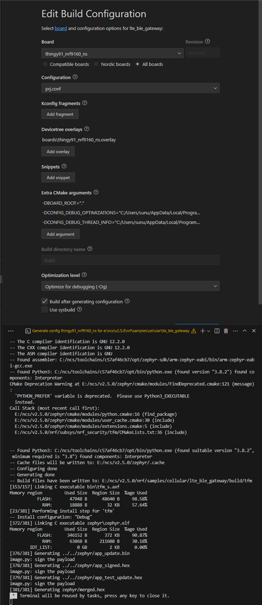

    Did you build the lte_ble_gateway sample with this configuration board: thingy91_nrf9160_ns ? If I try to build the sample with status = "disabled"; in my overlay file I will get this compilation error:
    -- Found Python3: /home/esc/ncs/toolchains/7795df4459/usr/local/bin/python3.8 (found suitable version "3.8.2", minimum required is "3.8") found components: Interpreter

    FATAL ERROR: command exited with status 1: /home/esc/ncs/toolchains/7795df4459/usr/local/bin/cmake --build /home/esc/versions/lte_ble_gateway/build
    I think it tells that the uart1 pin cannot be accessed (which is what we changed in the .overlay file) and I don't know how can you compile with status = "disabled"; in your thingy91_nrf9160_ns.overlay overlay file.
    I am also wondering why are you talking about the Connectivity Bridge sample ? The only 2 samples I use are hci_lpuart for the 52 chip and lte_ble_gateway for the 91 chip.
    And the builds of these 3 are independent so I don't get how changing something in applications/connectivity_bridge/app.overlay (which I never used) could affect the compilation of any other sample.

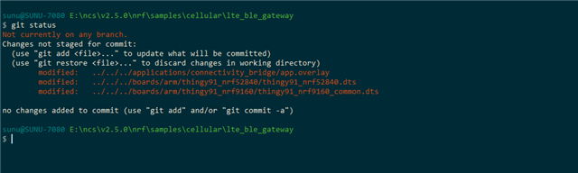

    Yes,
    Please see below
    I did not create any overlay file I changed the exact same way as in the PR I linked in the files
    boards/arm/thingy91_nrf52840/thingy91_nrf52840.dts
    boards/arm/thingy91_nrf9160/thingy91_nrf9160_common.dts
    As mentioned here

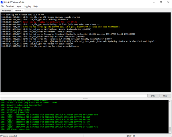

  • Oh okay I did not understand I had to change it directly in the source sdk .dts files. So I did that, it compiles well on both hci_lpuart sample and lte_ble_gateway.
    However, the problem persists:
    *** Booting nRF Connect SDK v2.5.0 ***
    [00:00:00.256,896] <inf> lte_ble_gw: LTE Sensor Gateway sample started
    [00:00:00.257,049] <inf> lte_ble_gw: Initializing Bluetooth..
    [00:00:00.505,706] <inf> lte_ble_gw: Establishing LTE link (this may take some time) ...
    [00:00:04.321,807] <wrn> lpuart: req pin low when expected high
    [00:00:04.321,960] <err> lpuart: Empty receiver state:4
    ASSERTION FAIL [err == 0] @ WEST_TOPDIR/zephyr/subsys/bluetooth/host/hci_core.c:338
      command opcode 0x0c03 timeout with err -11
    [00:00:10.267,547] <err> os: r0/a1:  0x00000003  r1/a2:  0x00000000  r2/a3:  0x00000002

  • Please install fresh SDK (or do a git reset --hard on your current one)
    I strongly suggest you to try NCSv2.5.0 as this is the one I am testing.
    Please try these hex files for nRF91 try below lte_ble_gateway
    merged_91.hex
    nRF52 try below (this is hci_lpuart)
    merged_52.hex
    I do not see the fault.
    I have no other changes in my SDK
