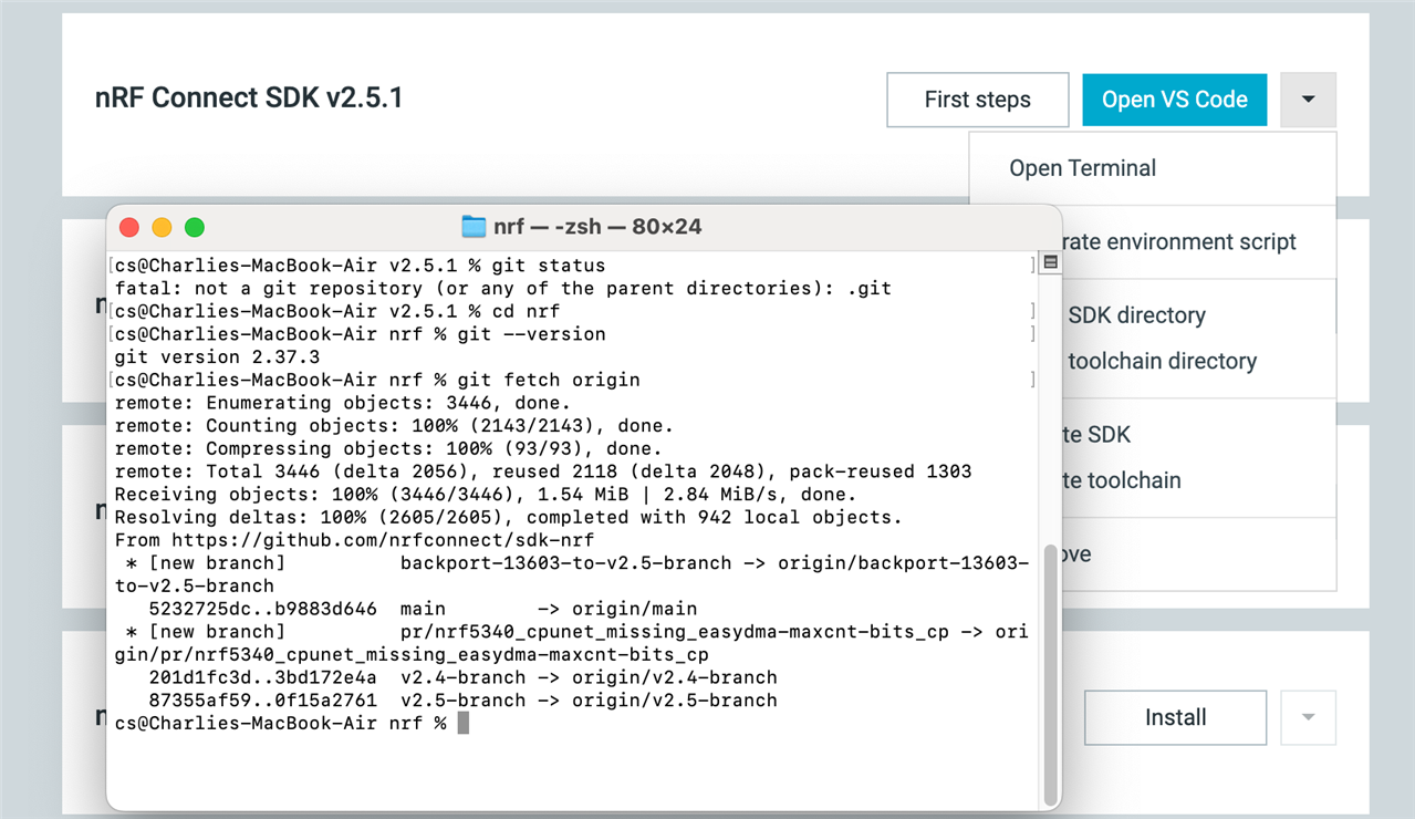

  • Hi Rgds,
    Sorry to hear the problem still exists. Let's collect a bit more information from your setup and installation process.
    From the above page, you can click "create system report" to generate a report about your system and share it here.
    I assume you have turned on the "VERBOSE LOGGING" switch. You can rerun installing nRF Connect SDK v2.5.1, then click "OPEN LOG FILE", a detailed log file will open and you can share it here.
    Charlie

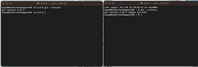

    *************** Here is the System report
    # nRFConnect System Report - 2024-01-08T20-44-13.311Z
    - System: Apple Inc. MacBookPro15,1
    - BIOS: Apple Inc. 2020.61.1.0.0
    - CPU: 1 x Intel CoreTm i7-8750H 2.2 GHz 12 cores (6 physical)
    - Memory: 302.1 MB free of 16 GB total
    - Filesystem: /dev/disk1s5s1 (APFS) 931.5 GB 10.6% used
    - OS: macOS (14.2.1) darwin x64
    - Versions
    - kernel: 23.2.0
    - git: 2.39.3
    - node: 16.17.1
    - python:
    - python3: 3.9.6
    - Connected devices:

  • Hi JRSN,
    Thanks for the information. I am still looking for the cause for "Failed to clone the repositories: Error: Cloning into '/opt/nordic/ncs/v2.5.1/.west/manifest-tmp'" error.
    Just wondering if you have tested on another network environment like home if you only tested in the office or vice versa?
    Another worth trying might be simply testing on a Windows PC to see if the issue also exists.
    Charlie
