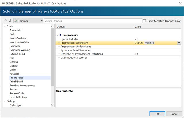

    To be able to develop an application you should get familiar with debugging.
    You should add DEBUG here:

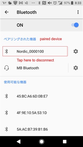

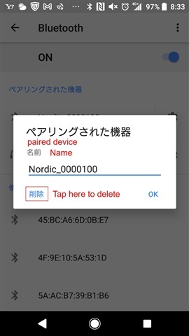

    I was able to successfully connect to my smartphone, but was unable to disconnect. Security was in working order, which gave me some hope.

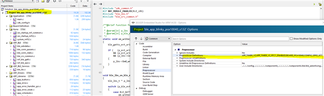

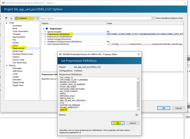

    To add DEBUG you would need to go to Project setting, not solution setting.
    It should have other setting for example APP_TIMER_V2 ,...
    It should look like this:

    To add >DEBUG you need to go to the project settings, not the solution settings.
    →As you taught me, I added "DEBUG" in the project settings, but the result was the same. Therefore, after setting, the error log will not be visible in the terminal software.
