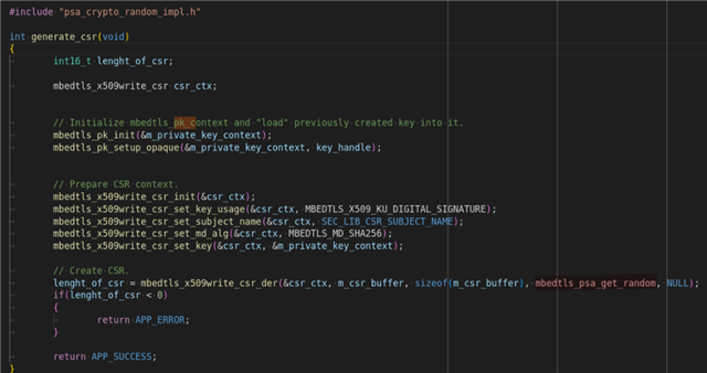

    I upgraded the existing persistent_key_usage example with mbedtls functionality, in order to additionally describe the problem.
    In the code below, I tried to generate a CSR using a key generated with the "PSA_KEY_LIFETIME_PERSISTENT" attribute (in the posts above I mentioned the ECDSA signature, but for the simplicity of this example I chose to present the problem through generating a CSR).

    int generate_csr(void)
    	int status;
    	int16_t lenght_of_csr;
    	mbedtls_x509write_csr csr_ctx;
    	mbedtls_entropy_context     m_entropy_ctx;
    	mbedtls_ctr_drbg_context    m_ctr_drbg_ctx;
    	// Initialize mbedtls_pk_context and "load" previously created key into it.
    	mbedtls_pk_init(&m_private_key_context);
    	mbedtls_pk_setup_opaque(&m_private_key_context, key_handle);
    	// Initialize drbg context.
    	mbedtls_entropy_init(&m_entropy_ctx);
        mbedtls_ctr_drbg_init(&m_ctr_drbg_ctx);
        status = mbedtls_ctr_drbg_seed(&m_ctr_drbg_ctx, mbedtls_entropy_func, &m_entropy_ctx, NULL, 0);
        if(status != 0)
            return APP_ERROR;
    	// Prepare CSR context.
    	mbedtls_x509write_csr_init(&csr_ctx);
        mbedtls_x509write_csr_set_key_usage(&csr_ctx, MBEDTLS_X509_KU_DIGITAL_SIGNATURE);
        mbedtls_x509write_csr_set_subject_name(&csr_ctx, SEC_LIB_CSR_SUBJECT_NAME);
        mbedtls_x509write_csr_set_md_alg(&csr_ctx, MBEDTLS_MD_SHA256);
        mbedtls_x509write_csr_set_key(&csr_ctx, &m_private_key_context);
    	// Create CSR.
        lenght_of_csr = mbedtls_x509write_csr_der(&csr_ctx, m_csr_buffer, sizeof(m_csr_buffer), mbedtls_ctr_drbg_random, &m_ctr_drbg_ctx);
    	if(lenght_of_csr < 0)
    		return APP_ERROR;
    	return APP_SUCCESS;

    With the configuration from the prj file mentioned in the first post I got the following errors:
    - "undefined reference to `mbedtls_pk_setup_opaque" - MBEDTLS_USE_PSA_CRYPTO was not defined in pk.h, although it was enabled with CONFIG_MBEDTLS_USE_PSA_CRYPTO=y.
    - The key generation (psa_generate_key) failing because in psa_validate_key_persistence MBEDTLS_PSA_CRYPTO_STORAGE_C was not defined (also enabled with the CONFIG_MBEDTLS_PSA_CRYPTO_STORAGE_C=y)
    I solved both problems only when I included in nrf-config-user.h:
    #define MBEDTLS_PSA_CRYPTO_STORAGE_C 1
    #define MBEDTLS_USE_PSA_CRYPTO 1
    If I build the nrf/samples/crypto/ecdsa sample with your above configs except for EXTERNAL_RNG (it makes the build fail), I get MBEDTLS_USE_PSA_CRYPTO=y
    If I understood you correctly, you didn't have to additionally include MBEDTLS_USE_PSA_CRYPTO through the nrf-config-user.h file?
    Currently, there is the following problem with the mbedtls_x509write_csr_der function, that I haven't solved yet:
    Such function returns the value PSA_ERROR_NOT_SUPPORTED (from the inside call psa_driver_wrapper_export_public_key).
    Can you help me find what is missing in the configuration?

    Maybe try to set CONFIG_MBEDTLS_KEY_EXCHANGE_ALL_ENABLED?
    Also, have a look at your build log. Sometimes CONFIGs will be ignored from the prj.conf, which appears as warnings in the log. Maybe some of the configurations you thought you had set are ignored?
    I can copy the code you posted, and I did, but it is hard to know if I missed any changes. Could you zip the test you have and upload it? Then I can test the exact same project as you run and see if I can find anything.
  • Hello Sigurd,
    I completely agree it would be best to package the whole example and upload it.
    Unfortunately, our firewall does not allow us to upload such content here (regardless of whether is related to the demonstration of common/basic functionalities from sdk).
    I was hoping you could easily reproduce the problem by simply updating the main.c and .prj.conf files from the nrf_230\v2.3.0\nrf\samples\crypto\persistent_key_usage\ demo. These are the only changes I made to the persistent_key_usage demo in order to reproduce the problems from the project I'm working on.
    In any case, thank you for your help, I will consult with my colleagues here on how to proceed with this.
