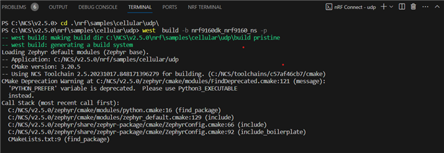

It does matter how you install nRF Connect SDK(NCS), either the Toolchain manager app or VS code extension.
After you finish the NCS deployment, you can use the command line under the nRF Connect Terminal like the following picture.
