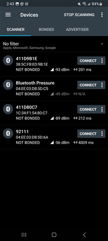

I am currently trying to set up a filter to connect to a device based on its name. I will attach my scan init and scan start to show how I have this configured. I want to be able to connect to the device in the scan event handler when a match is found, but I am not hitting the breakpoint in that handler. I have set my target device to static char const target_device_name[] = "Bluetooth Pressure"; I have also attached the nRF Connect screen showing the device name. I am using sdk 17.0.2 as well.
