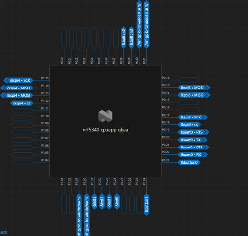

    Anyway, QSPI is currently disabled and M95P32 control via SPI has been completed,
    is MCU BOOT section able to describe clearly how to implement this?

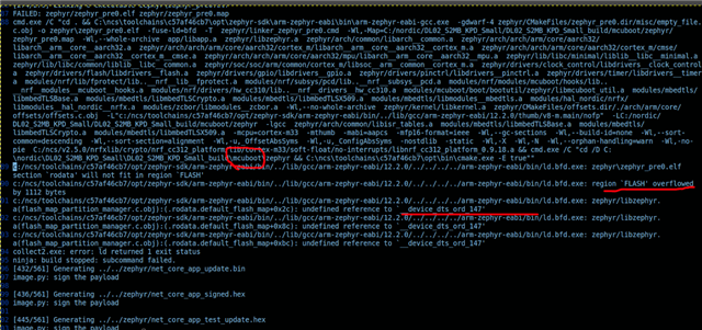

  • Hi Sigurd
    The compiler will report an error when I modify the "child image"

    devicetree error: /chosen: undefined node label 'eeprom_m95p32'
    CMake Error at C:/ncs/v2.5.0/zephyr/cmake/modules/dts.cmake:279 (message):
    -- In: C:/nordic/DL02_S2MB_KPD_Small/DL02_S2MB_KPD_Small_build/mcuboot/zephyr, command: C:/ncs/toolchains/c57af46cb7/opt/bin/python.exe;C:/ncs/v2.5.0/zephyr/scripts/dts/gen_defines.py;--dts;C:/nordic/DL02_S2MB_KPD_Small/DL02_S2MB_KPD_Small_build/mcuboot/zephyr/zephyr.dts.pre;--dtc-flags;'-Wno-unique_unit_address_if_enabled';--bindings-dirs;C:/ncs/v2.5.0/nrf/dts/bindings;C:/ncs/v2.5.0/zephyr/dts/bindings;--header-out;C:/nordic/DL02_S2MB_KPD_Small/DL02_S2MB_KPD_Small_build/mcuboot/zephyr/include/generated/devicetree_generated.h.new;--dts-out;C:/nordic/DL02_S2MB_KPD_Small/DL02_S2MB_KPD_Small_build/mcuboot/zephyr/zephyr.dts.new;--edt-pickle-out;C:/nordic/DL02_S2MB_KPD_Small/DL02_S2MB_KPD_Small_build/mcuboot/zephyr/edt.pickle;--vendor-prefixes;C:/ncs/v2.5.0/nrf/dts/bindings/vendor-prefixes.txt;--vendor-prefixes;C:/ncs/v2.5.0/zephyr/dts/bindings/vendor-prefixes.txt
      gen_defines.py failed with return code: 1
      C:/ncs/v2.5.0/zephyr/cmake/modules/zephyr_default.cmake:129 (include)
      C:/ncs/v2.5.0/zephyr/share/zephyr-package/cmake/ZephyrConfig.cmake:66 (include)
      C:/ncs/v2.5.0/zephyr/share/zephyr-package/cmake/ZephyrConfig.cmake:97 (include_boilerplate)
      CMakeLists.txt:31 (find_package)
    See also "C:/nordic/DL02_S2MB_KPD_Small/DL02_S2MB_KPD_Small_build/mcuboot/CMakeFiles/CMakeOutput.log".
    See also "C:/nordic/DL02_S2MB_KPD_Small/DL02_S2MB_KPD_Small_build/mcuboot/CMakeFiles/CMakeError.log".
    CMake Error at C:/ncs/v2.5.0/nrf/cmake/multi_image.cmake:449 (message):
      CMake generation for mcuboot failed, aborting.  Command: 1
      C:/ncs/v2.5.0/nrf/cmake/multi_image.cmake:178 (add_child_image_from_source)
      C:/ncs/v2.5.0/nrf/modules/mcuboot/CMakeLists.txt:268 (add_child_image)
    See also "C:/nordic/DL02_S2MB_KPD_Small/DL02_S2MB_KPD_Small_build/CMakeFiles/CMakeOutput.log".
    See also "C:/nordic/DL02_S2MB_KPD_Small/DL02_S2MB_KPD_Small_build/CMakeFiles/CMakeError.log".
    FAILED: build.ninja
    C:\ncs\toolchains\c57af46cb7\opt\bin\cmake.exe --regenerate-during-build -SC:\nordic\DL02_S2MB_KPD_Small -BC:\nordic\DL02_S2MB_KPD_Small\DL02_S2MB_KPD_Small_build
    ninja: error: rebuilding 'build.ninja': subcommand failed
    FATAL ERROR: command exited with status 1: 'C:\ncs\toolchains\c57af46cb7\opt\bin\cmake.EXE' --build 'c:\nordic\DL02_S2MB_KPD_Small\DL02_S2MB_KPD_Small_build'
  • The error is "devicetree error: /chosen: undefined node label 'eeprom_m95p32'"
    Can you share the file where you define the dts for eeprom_m95p32?
