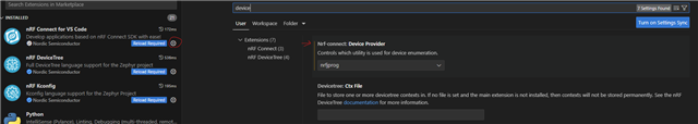

    Could you check the following:
    1. The device provider in the VS Code extension:
      1. Open the extension setting and search for "Device Provider". Verify that the Mac and Ubuntu machine has the same version
    2. To my understanding you would require to have either a UART converter on the PC, or JLink. Could you verify if the Mac has this set up?
    PS: You might also want to check if your device is a ttyACMn and not a ttyUSBn (n is a number). The USB on the DK is typically ttyACMn, while ttyUSB suggests that you have a usb to seriel cable. I believe it might be a Linux + RTT to USB adapter problem. Could you state which model of RTT to USB you're using?
