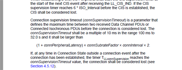

When you see an error pointing to a line in the code, please open the code where the error is. At line 193 in gatt.c you can find this:
BUILD_ASSERT((CONFIG_BT_PERIPHERAL_PREF_TIMEOUT * 4U) > ((1U + CONFIG_BT_PERIPHERAL_PREF_LATENCY) * CONFIG_BT_PERIPHERAL_PREF_MAX_INT));

Hi Thibaud,
Disconnection reason 8 means connection timed out.
Please try to disable peripheral latency and test again. Also please try to increase the connection timeout.
If the connection was caused by interference and packet drop the peripheral latency will increase the chance of connection timeout.
