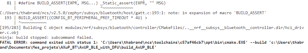

I would like to understand why I have this error when I put CONFIG_BT_PERIPHERAL_PRE_LATENCY above 3.
Note : I am developping an application using HID over GATT and SMP services on nRF Connect SDK v2.5.0

The product is working even if there is this message, that is why I qualified it as a warning. I don't think it is such a big issue.
I would reproduce the problem and take a screenshot.
I've tried with my application which is based on peripheral_hids_keyboard sample. I just added dfu ota fonctionnality.
