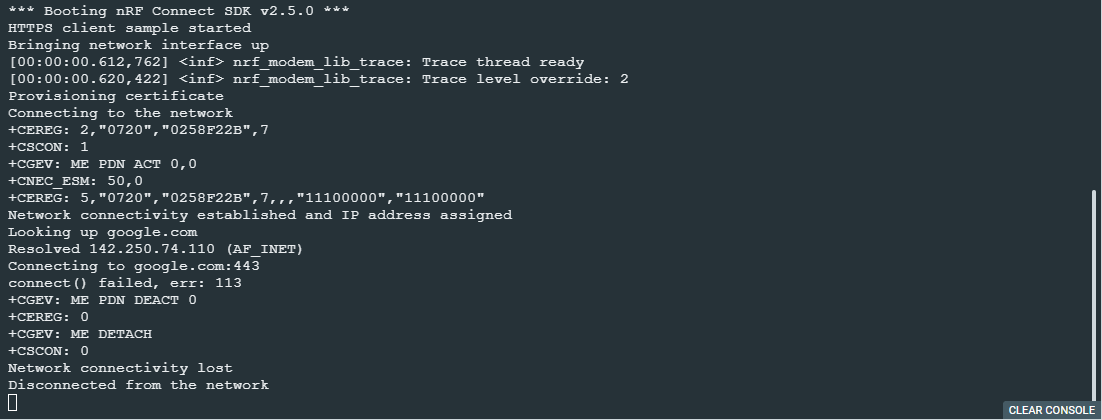

[nRF9160DK] tls error, Alert (Lever: Fatal, Description: Internal Error
Hi, I'm developing HTTPS request with tls, using HTTPS_Client example in Zephyr OS.
Try to connect nRF 9160DK Board with google.com:443, but it didnt work.

 And this is terminal result.

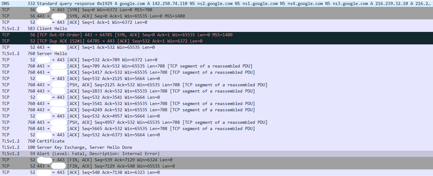

And this is error message got from wireshark.
Every Comment will be helpful to me.

    Which MFW are you using?
    Could you try to use the GTS Root R1 (gtsr1.pem) instead of GTS CA 1C3?
    Here's my output when using the root ca:

  • Thank you so much for your reply!!
    You're reply was great help to me.
    my MFW is 1.3.
    And I changed my CA certificate, but I didn't works well.
    So I change my config options and it works.
    I used "boaeds\nrf9160dk_nrf9160_ns_conf"
    Thanks to your reply!
