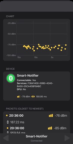

Since the upgrade, I haven't been seeing Value attribute in the BLE service modifying despite being set via
sd_ble_gatts_hvx
Can't upload photos (nrf website being buggy)
Thanks for confirming. Could you please post the log from the nRF Connect app after you have enabled the notification?
How to view the log?
Here:
OK weird. sd_ble_gatts_hvx now returns 8.

Please go to iOS settings -> Bluetooth, and toggle Bluetooth off and then back on. After that, try to connect with the nrf connect app and enable notifications again. Toggling Bluetooth enable will clear the attribute cache and this might be necessary if you have been using the same board with different firmware.
