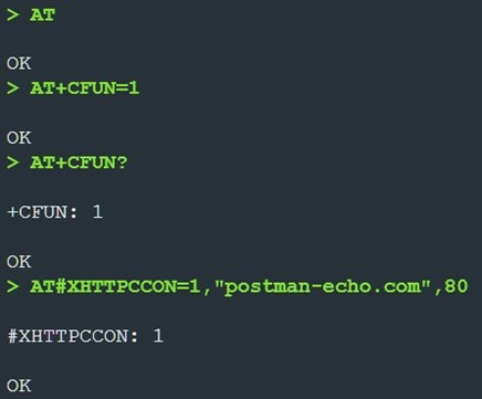

On nRF9160DK, I have installed the "Serial LTE Modem" application. DK is connected via USB to a Windows PC. It works just fine with nRF Connect for Desktop apps (LTE Link Monitor and Serial Terminal), and I can send AT commands and receive responses, both Modem-specific AT commands and Proprietary AT commands.
However, when I try to send AT via Putty terminal, I don't get any response. The same is true when I try to send AT commands with Python script (serial module) on Windows or Raspberry Pi 4B (nrfDK is also connected via USB).

nrf connect for desktop                                 putty
