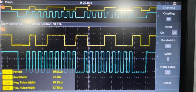

  • Hi I tried to probe the I2C pins of nRF52840 DK it is writing properly to LCD even though LCD glitch happening. attaching the video for your reference. Could it be hardware issue ?
    It is hard to see exactly from the video of the oscilloscope, but at least the waveforms looks correct indeed, but it could still be a hardware issue with the LCD, yes.
    Was this scoped at the output of the nRF52?
    Do you have another LCD screen which you could perform a swap test with, i.e swap out the LCD shown here with the other LCD, to see if the other one behaves exactly the same?
    In general, is the unexpected symbols that show up always the same?
    It seems to me that it in the first part of the video functions as expected, and then in the second half it does not anymore - is there any difference to the test setup or program in the two instances?

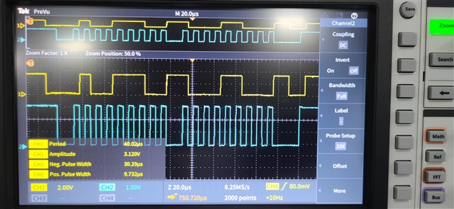

  • Yes in the first part of the video it was the expected one, and second part is with the. LCD glitch. I tried the swap test also but getting the same issue.Also tried to probe the pins after swapping the LCD. I think I2C com is fine. Properly writing data to LCD. Attaching the images before and after LCD glitches
    Thank you for sharing this additional information as well.
    The flanks/characteristics for the communication looks correct in the shared screenshots, yes.
    The last thing we should check in this regard is that the written symbols actually
    You could do this by either going through the code to see that there are no chance these symbols could be the result of a memory shift, or similar, or to check this by exporting the trace from the logic analyzer/oscilloscope and verifying what is written this way.
