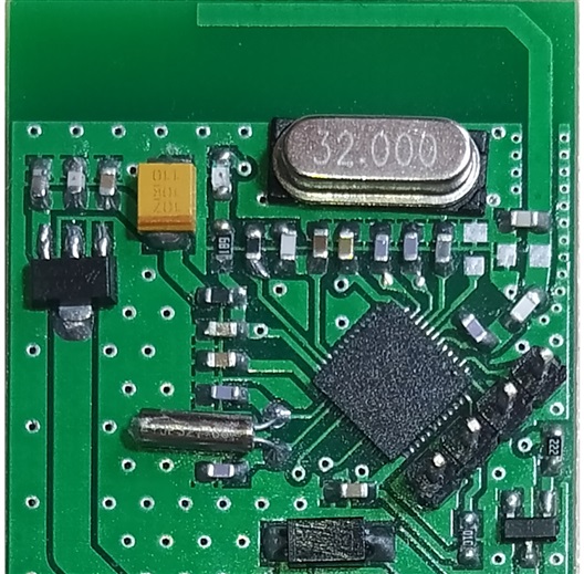

I have 4 boards based on nRF52832 that I've designed by myself.

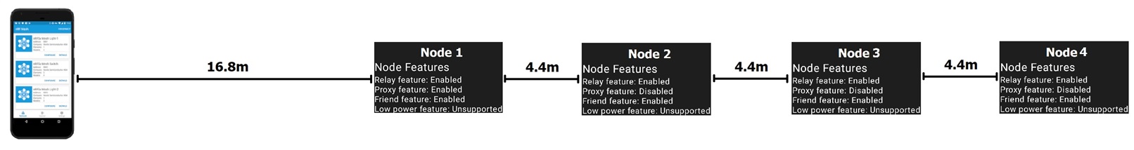

For Bluetooth Mesh I placed boards serially in a straight line and you can see nodes features like as relay or proxy settings in below. It's the maximum range that I could achieve:
By changing PHY and TX values, the below result achieved between every two nodes:
PHY: 1Mbps   TX: 0dbm    > 1.6m
PHY: 1Mbps   TX: +3dbm  > 2.4m
PHY: 1Mbps   TX: +4dbm  > 4.4m
PHY: 2Mbps   TX: 0dbm    > 1.6m
PHY: 2Mbps   TX: +3dbm  > 2.4m
PHY: 2Mbps   TX: +4dbm  > 4.4m
As you can see, the result isn't differ for 1Mbps or 2Mbps PHY setting.

I know that the most efficiency is related to antenna design and tuning but because I haven't any experience about it, so I copied the antenna part of PCA10040-nRF52832 PCB board.
You can see my PCB in below:

3. Why advertising range is about 16m but for Bluetooth Mesh, node to node range is below than 5m? (I checked advertising range by nRF Connect app)
4. Why Node 1 responds me in the range of 16.8m without losing the connection but the other Nodes can't communicate by themselves in this range and can't be more than 4.4m?
    Is it related to proxy feature of Node 1 that others lack it? In the other words what's the difference between proxy feature that my phone and Node 1 use it and relay feature that the other communicate by themselves and how it influence the response distance range? (It's very brilliant for me if other boards can communicate with each other in 16.8m, too).

    1) Why do you expect the range to differ som 1mbps and 2mbps?
    2) Increasing the TX power would be the best bet to increase the range significantly. Having only 4m is very low, but that might be due to HW limitations.
    3) This might be because the communication before provisioning is significantly "lighter" compared to after. And less prone to packet loss.
    4) Not sure, but it might be related to the antenna or hw layout on the phone is allowing it to maintain longer range.
    5)
    There are more then one way to "tune" the antenna, but the best and fastest way is to connect it to a Networks analyzer and modify length and matching components.
    It is possible to simulate and calculate what size, width, length an so on would be best and do simulations with matching components to get the best possible result. This would have to be incorporated in to the design before production.
    Easiest option is to send two devices to us and we can do the tuning of the antenna as well as match the radio for best performance.

  • Thanks a lot Joakim for your quick and complete reply.
    I'm here with new questions.
    How soldering the exposed pad of nRF52832 can affect the antenna range?
        As I learned by Nordic documents, it's very important to provide a very good ground plane for the chip. But because I soldered the chip by hand, I couldn't solder the exposed pad.
    Can selecting the internal LDO regulator affects the antenna range compared with internal DCDC regulator?
        My PCB configuration is based on internal DCDC regulator.
    How new versions of chip can affect the antenna range?
        I saw that in some posts, Nordic engineers ask about the version code of chip. For my, the chip version is E0 and is manufactured in 23th week of 2018:
        N52832
        QFAAE0
        1823FC
    Best regards
    Mehdi

  • Hi again.
    The response I got was that this would probably be fine for prototyping, but could result in reduced performance. But with no indication about how much it would affect it.
    It could cause 1-2 dB less sensitivity for the nRF52832 with DCDC compared to LDO. This could also be worse if the exposed pad isn't soldered.
    As far as I know this shouldn't affect the range noticeably.
    Br,
    Joakim
