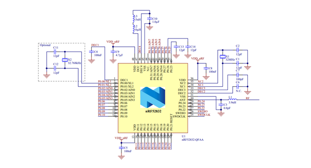

I've been struggling with a board issue for a week now. I'm using the nRF52835 with an external antenna. I'm trying to run an example after installing the nRF Connect SDK. I've loaded various Bluetooth examples from both the nRF SDK (via Segger IDE) and the nRF Connect SDK, but the device is not being discovered. In my understanding, both examples should work out of the box, but unfortunately, they don't. I've uploaded the projects to the cloud. Link to the files https://drive.google.com/file/d/15gjsuDHun9xgwL13yR_y65k9e1L3tR-k/view?usp=sharing (Versions: NRF SDK 1.7.0, nrf-connect sdk 2.5.0)
When using nRF Connect, I've set the build configuration to the nRF52DK board and tried creating a custom one, but neither option worked. LED examples are working fine. I'm trying to find a BLE device with my phone.

  • And how can i set up clocking using an external high-frequency crystal correctly?
    The clock will automatically be chosen by one of the Kconfigs that you provide, looking at your schematic there is multiple points that should be addressed:
    1. The high frequency crystal needs parallel load capacitors
    2. You need to replicate the same size for the matching components as in the reference design that means 0.8 pF and 3.9 nH,
    3. You do not have decoupling on VDD
    4. You're missing an inductor for the DC/DC
    reference design:
    Try setting CONFIG_BOARD_ENABLE_DCDC=n in the project config and see if it works,
    regards
    Jared
