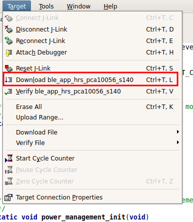

I use Segger embedded studio to upload my firmware to my nRF52840 custom board. When I do it with build and run button everything works as expected but when I do it from Target > Download File > Download .elf file, nothing seems to work. What am I doing wrong?
Thanks
    Does it work if you click this button instead:
    ? Note that the "Download .elf" button will only program the application FW. It will not include other files such as the Softdevice.
