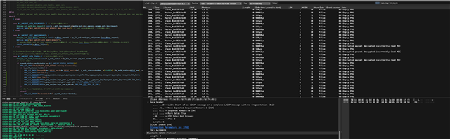

  • Hi Keigo,
    It seems like the central managed to reconnect so I am not sure why the write command was not sent.
    My suggestion is to use a sniffer to capture the communication. This would give us more insight of what could be wrong. You may have issue decrypting the paired connection with the sniffer if you secure connection, but you may consider turn off pairing for the test.
    Please double check the code of the central to see if it actually send the write command on the 2nd connection or not.

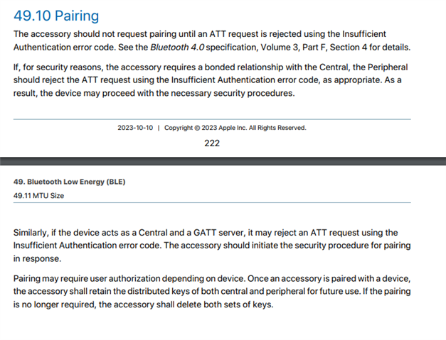

    Is it possible to communicate with the Central without pairing by turning off pairing?
    Also, since the Central receives finished products from the trading company and is not involved in the internal software, I have no knowledge of it.
    Furthermore, it seems that there are other companies creating peripherals that collaborate with this Central using Nordic.
    However, before using Nordic chips, I successfully communicated with the Central using a peripheral with Linux's BlueZ.
    At that time, even after reconnecting, the write events were received properly.
    Therefore, it seems there may be an issue with the peripheral I am trying to implement with Nordic this time.

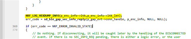

  • Hello Mr. Hung Bui,
    Following your advice, I implemented dumping the LTK in the security_manager.c file. I tried entering the 16-byte key that appeared here into the sniffer, but I'm still encountering the "Encrypted packet decrypted incorrectly" issue. Does this mean that decryption was unsuccessful? Additionally, does this imply that encrypted communication between the Central and Peripheral is not working well after reconnection?
    Also, is it possible to receive the code you experimented with, Mr. Hung Bui?

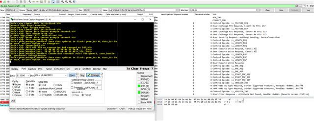

  • Hi Keigo,
    I was testing with ble_app_hrs in SDK v17.1 with the only modification that I showed you.
    Could you try to test again with the example and try to connect and pair with a phone ?
    Make sure you click the arrow button after you enter the key (it turns blue when the key is entered and then turns gray after you click it).
    And after that the sniffer needs to capture a new connection, it will not be able to decrypt something it already captured.
    How long the connection last after you get "Encrypted packet decrypted incorrectly" ?
    Usually this error just shows that the sniffer couldn't decrypt the connection, there is nothing wrong between the peripheral and the central.

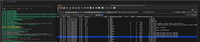

  • Hello, Mr. Hung Bui.
    After setting the key, I clicked the arrow button to confirm the changes in the display. Following that, I captured a new connection, but it is currently in a state where the output reads "Encrypted packet decrypted incorrectly (bad MIC)." It seems that the sniffer is unable to decrypt the connection for some reason. I will also try using ble_app_hrs.
    Additionally, I am considering implementing the central side and trying to debug by checking the peripheral side as well. (Debugging from the central perspective is challenging as it involves a product from a different company.)
  • I'm not so sure why it doesn't work in your case. Have you tried again with a phone and a SDK example ?
    You can also try to turn off Secure Connection so that it will do Legacy pairing, then it's much easier to sniff the communication without the need for LTK. If the central accept legacy pairing I think it's what you should do to debug.
  • Good evening, Mr. Hung Bui,
    I tried using ble_app_hrs and checked with both the nrf52840 and a mobile phone. However, when I entered the Long Term Key (LTK) that appears during reconnection into the sniffer, I encountered the message "Encrypted packet decrypted incorrectly (bad MIC)."
    Furthermore, it seems that the central device I am trying to connect to does not support legacy pairing.

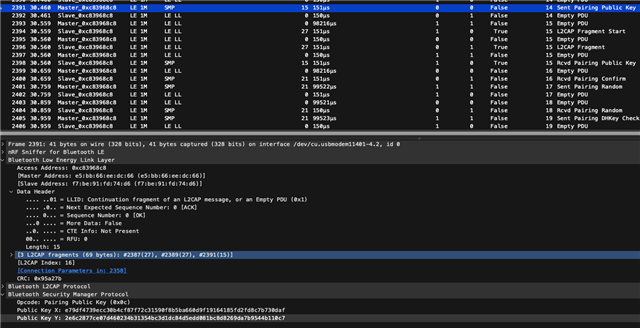

  • This is so strange. I tried again with another bonding and new LTK key and it worked just fine.
    Could you check if you are having latest sniffer version. Which wireshark version do you have ?
    If you have a screen recording that you record the whole test it would be nice.
    Please send us the sniffer trace as well.
  • Dear Mr. Hung Bui,
    It's been a while. Regarding the LTK in the Sniffer, when I converted the alphabet to lowercase, Wireshark started decrypting it!
    Furthermore, there was an issue during reconnection where the Central stopped sending Write requests. Upon sending the Sniffer data to the company developing the Central, it was pointed out that the problem lies in the fact that the Peripheral is issuing a Security Request during reconnection. Since the PM_HANDLER_SEC_DELAY_MS was set to 0, changing it to 4000 resolved the issue. However, after the delay, the delayed_conn_secure function is called, but after 4000ms, the encrypted communication is already established, leading to the following code snippet not initiating the security procedure:

    Regarding your question, a common practice for securing the connection is to let the central handling it. The peripheral should instead set the security level of the characteristic/service to the level that it desired.
    For example you can find the instruction in the Apple Bluetooth design guideline here at section 49.10:
    https://developer.apple.com/accessories/Accessory-Design-Guidelines.pdf
    I think what you are implementing is fine, giving the central time to secure the connection, if it doesn't (after 4 seconds) you can start requesting. You can choose to request or not, but as long as you set the security level for the service when you declare it, then it's fine.
