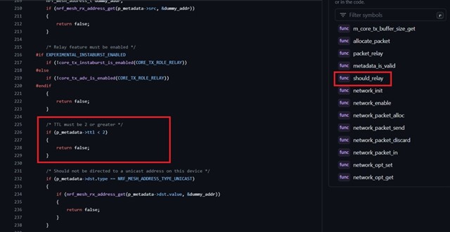

  • For example, this code clearly implies that TTL >= 2 for relaying to occur, which contradicts what I have read elsewhere.
    code that implies TTL >= 2
  • Hi Nicholas,
    I was a bit uncertain myself actually. It does sound right that a TTL of 1 would allow for one hop, but no, the code is right.
    The Mesh spec is the place to go when you are getting conflicting answers. TTL is described in a simple way in 3.4.4.4 "TTL":
    The TTL field is a 7-bit field. The following values are defined:
    • 0 = has not been relayed and will not be relayed
    • 1 = may have been relayed, but will not be relayed
    • 2 to 126 = may have been relayed and can be relayed
    • 127 = has not been relayed and can be relayed
    The initial value of this field is set by the transmitting layer (lower transport layer, upper transport layer, access, foundation model, model) or an application and used by the network layer when operating as a Relay node.
    The use of the TTL value of zero allows a node to transmit a Network PDU that it knows will not be relayed, and therefore the receiving node can determine that the sending node is a single radio link away. The use of a TTL value of one or larger cannot be used for such a determination.

  • So in conclusion:
    A node that is in range of the gateway can send messages with TTL=0 and they will be successfully transmitted to the gateway. In addition, the gateway will know which node the message came from because the message can only have made one "hop" to get there.
    A node that is out of range of the gateway and needs a message to be relayed must have a minimum value of TTL=2. More generally, the message must have a TTL>=2 at the last relay before the gateway. Messages arriving at a relay with TTL=1 or TTL=0 will not be relayed.
    So in the simplified system we started with, node 1 can send its own messages with TTL=0 and node 2 would need its messages to have TTL=2 to successfully reach the gateway.
