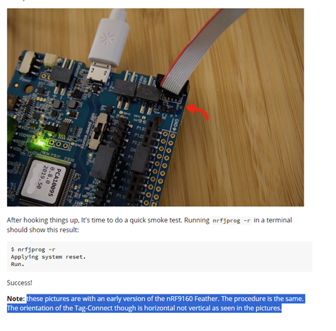

I have issues running: nrfjprog -r --log when the nrf9160  DK have a nrf9160 feather attached with a TC2030-CTX-NL 6-Pin cable.
nrfjprog version: 10.23.2 external
JLinkARM.dll version: 7.88j
Computer: mac
When I run the command: nrfjprog -r --log when the nrf9160 DK dont have the feather connected I get:
Applying system reset.
Run.
However, when the feather is connected:
[error] [ Client] - Encountered error -102: Command connect_to_emu_with_snr executed for 576 milliseconds with result -102
ERROR: Unable to connect to a debugger.
[error] [ Worker] - An unknown error.
ERROR: JLinkARM DLL reported an error. Try again. If error condition
ERROR: persists, run the same command again with argument –log, contact Nordic
ERROR: Semiconductor and provide the generated log.log file to them.
NOTE: For additional output, try running again with logging enabled (–log).
NOTE: Any generated log error messages will be displayed.
I have followed this tutorial:
https://docs.circuitdojo.com/nrf9160-programming-and-debugging.html#requirements-for-external-programming
I have also run this:
nrfjprog –com
960045815 /dev/tty.usbmodem0009600458153 VCOM1
960045815 /dev/tty.usbmodem0009600458151 VCOM0
960045815 /dev/tty.usbmodem0009600458155 VCOM
FULL LOG:
