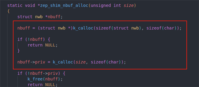

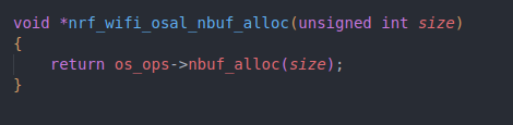

I am using the nrf7002 ek and attempting to optimise the RAM assignment for the project. I have reduced the size of several thread stack sizes as well as the heap in order for the application to fit onto my hardware. It's clear that I've cut too much RAM from at least one portion of the application though as I now get the error messages:
[00:00:00.623,138] <err> wifi_nrf: nrf_wifi_fmac_rx_cmd_send: No space for allocating RX buffer
[00:00:00.623,199] <err> wifi_nrf: nrf_wifi_fmac_init_rx: nrf_wifi_fmac_rx_cmd_send(INIT) failed for desc_id = 39
[00:00:00.623,260] <err> wifi_nrf: nrf_wifi_fmac_fw_init: Init RX failed
[00:00:00.623,962] <err> wifi_nrf: nrf_wifi_fmac_dev_init: nrf_wifi_fmac_fw_init failed
[00:00:00.623,992] <err> wifi_nrf: nrf_wifi_fmac_dev_add_zep: nrf_wifi_fmac_dev_init failed
[00:00:00.624,023] <err> wifi_nrf: nrf_wifi_if_init_zep: nrf_wifi_fmac_dev_add_zep failed
[00:00:00.624,450] <err> wifi_nrf: nrf_wifi_if_start_zep: Invalid MAC address: <unknown>
Are you able to help with which thread stack size or heap might need expanding to solve this? In general is there an easy way to know which area of RAM the application is targeting at any given time? I am aware of the Zephyr thread analyser which has been very helpful already.
