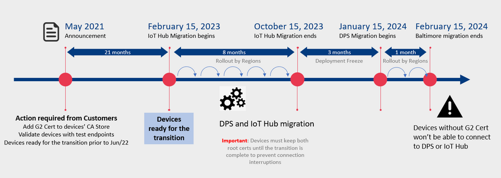

    Thanks for checking with us. The error is also reported in the following case. Have you read through it before to find some hint?
    (+) Sample Azure IoT Hub (Thingy9.1) - Nordic Q&A - Nordic DevZone - Nordic DevZone (nordicsemi.com)

  • Hi Thomas,
    Here is the brief report from my tests.
    1) No DSP
    I got the same -111 error as you did on the first try, but when I replaced BaltimoreCyberTrustRoot.crt.pem with DigiCertGlobalRootG2.crt.pem as root CA or set DigiCertGlobalRootG2.crt.pem rootCA, client certificate and private key in second security tag 11,
    then the issue is solved.

    What I have observed is fit for the CA migration timeline you can find from the following page. BaltimoreCyberTrustRoot.crt.pem is not valid for IoT Hub any more after October 15, 2023, but still valid for DSP, until February 15, 2024.
    Azure IoT TLS: Critical changes are almost here! (…and why you should care) - Microsoft Community Hub
    Charlie

    I do know about the Baltimore/Digicert certificate change as I have several other device types and many devices running on the IoT Hub. The IoT hub I want to connect to is still using the Baltimore certificate. So I am registering this as  CONFIG_MQTT_HELPER_SEC_TAG. The certificates (PEM) was downloaded from a Microsoft page with a description of the two certificates.
    I am now going to spin up a new test IoT Hub in a region where I know it will run Digicert and test that situation.
