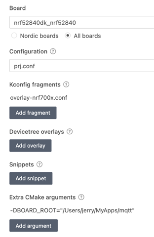

Build configuration is changed by the build process. I am working with the telnet sample.
I am having trouble with “shield not found” related to this is a problem where the build toolchain modifies my build configuration.
I am working on macOS Sonata 14.2 on a MacMini M2.
My target is a nrf52840dk_nrf52840/nrf7002ek combination.
I am working with the sample telnet application.
This is my build configuration:
When I hit configure build, I get the following:

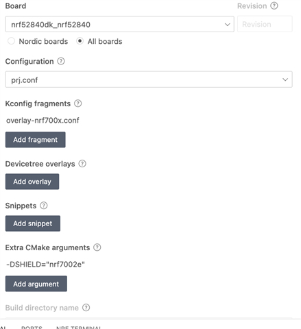

* Executing task: nRF Connect: Generate config nrf52840dk_nrf52840 for /Users/jerry/MyApps/telnet
Building telnet
west build --build-dir /Users/jerry/MyApps/telnet/build /Users/jerry/MyApps/telnet --pristine --board nrf52840dk_nrf52840 --no-sysbuild -- -DNCS_TOOLCHAIN_VERSION=NONE -DCONF_FILE=/Users/jerry/MyApps/telnet/prj.conf -DEXTRA_CONF_FILE=overlay-nrf700x.conf -DBOARD_ROOT=/Users/jerry/MyApps/mqtt -DSHIELD=nrf7002e

Now my build configuration has been changed as it appears as follows:
Note the differences in the CMake arguments!
I am baffled, befuddled, and bewildered!
Any help will be rewarded with positive thoughts and prayers.
Jerry
