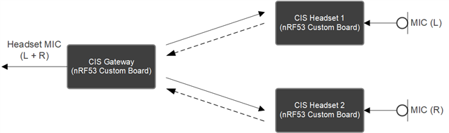

I'm considering bidirectional TWS in CIS.
In other words, I want the gateway to be able to output the microphone audio from the L and R headsets.

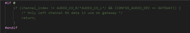

I found a description in the le_audio_rx_data_handler function of le_audio_rx.c that allows only the Lch signal to pass.
When I changed AUDIO_CH_L to AUDIO_CH_R, the audio from the R side headset was now played, but the audio from the L side was no longer played.
I tried disabling all of this description, but only the audio from the L side is played, and the audio from the R side is not played.
How should I edit the code to mix and play both L and R audio?

    Seems you want two microphones to one receiver.  If so, there is an unofficial https://github.com/rick1082/sdk-nrf/commits/dual_mic_sample/ for v2.4.2. You also could ping our FAE in JP to see the demo.
    “Beware that this code/configuration is not fully tested or qualified and should be considered provided “as-is”. Please test it with your application and let me know if you find any issues.”
    Amanda H.
    Rather than implementing two microphones in one receiver, I would like the gateway to output microphone signals from two headset boards at the same time, as shown in the figure below.
    Is it possible to achieve this with code editing for nrf5340_audio?
    Gotoda
  • This is exactly what the above demo code would like to achieve.

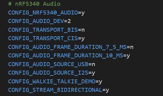

    I downloaded the project files you introduced, but the following build error occurs.

    How should I resolve this?

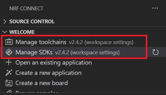

  • That sample is for v2.4.2. Could you build it with NCS v2.4.2?
  • I changed to v2.4.2 and built it, but the same error occurs.
