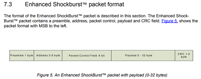

The Problem is, that I can't get the micro:bit receive packets send by the r0cket. I looked into the initalization code of the microbit and the one of the r0cket and I think that I configured both endpoints correctly. You can find my code of both sides below. As a proof of conecpt my first goal is to show the char send by the r0cket on the micro:bit screen.
I am relativly fluent in C and hardware near programming and therefore not fixed on the library on the nRF24L01+ side of things. I would however prefer to stay with this setup. On the micro:bit side of things I would prefer not to overload the learning curve with switching away from the micro:bit micropython environment.
I hope someone can point me into the right direction.
