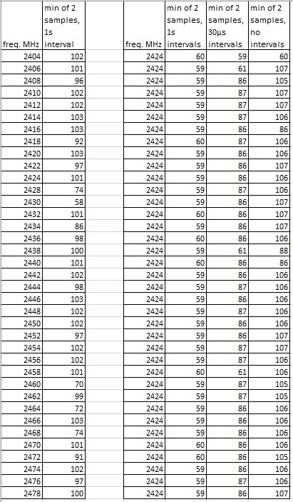

I'm working with nRF52840 (Laird BL653 DVK & dongle), using NCS 1.9.1.
I'm trying to get reliable RSSI "noise floor" sampling on a single RF channel or sweeping multiple channels, using these commands:

The configuration sequence is being executed only once on FW startup, while the sampling sequence is called multiple times during FW operation, with each time executing the sequence at least twice for each channel, with channel being any even number from 4 to 78 representing channel frequency. From the multiple sampling results only the minimal value is returned, giving the "noisiest" RSSI sample in -dBm.
I noticed that when the RSSI sampling is called multiple times with no time intervals between calls the minimal results are constantly very low (typically ~-105 dBm), while when sampled with intervals between calls (still each time calling the sequence twice but with variating periods between every calls-pair) the results increase until reaching a maximal value (which is similar to the result of only 2 samples alone with no iteration, typically ~-60 dBm).
These results are significantly different from each other, so I'm trying to understand this behavior and figure out if this is the proper way to get RSSI samples (perhaps enabling NRF_RADIO->TASKS_RXEN so frequently is causing the issue and should only be done once per every sampling sequence?).
Also, I noticed that when performing sweep scan on all channels I get about the same results on all of them, but when using the RSSI Viewer app (nRF Connect for Desktop v4.3.0) simultaneously I see a very different pattern.
Any assistance here would be much appreciated. Thanks in advance!

  • I scan RF channels 0-36 without advertising channels (= all even frequencies between 2404-2478 excluding 2426).
    Here is an output example of noise floor sampling, table to the left iterates all channels with long time intervals, table to the right sampled only single channel with variating intervals between samples:

    Channel 32, RSSI 104
    103 103 103 103 102 104 104 105 104 102
    Channel 33, RSSI 102
    102 103 102 104 104 102 102 102 104 71
    Channel 34, RSSI 71
    72 74 73 72 102 103 75 104 51 54
    Channel 35, RSSI 54
    104 102 104 104 103 102 103 103 103 103
    Channel 36, RSSI 103
    96 103 104 103 104 103 103 104 102 103
    Channel 37, RSSI 103
    57 104 105 104 102 103 105 104 104 103
    Channel 38, RSSI 103
    103 103 103 104 104 103 102 99 94 104
    Channel 39, RSSI 104
    103 103 103 96 102 102 100 103 101 96
    Channel 40, RSSI 96
    102 103 103 102 105 104 102 103 94 101
    Channel 41, RSSI 101
    102 103 101 104 103 104 104 103 103 103
    Channel 42, RSSI 103
    96 101 103 104 103 104 102 103 103 103
    Channel 43, RSSI 103
    104 102 104 103 103 103 103 104 103 103
    Channel 44, RSSI 103
    98 105 103 103 104 103 103 102 103 103
    Channel 45, RSSI 103
    101 104 104 104 103 101 102 92 103 104
    Channel 46, RSSI 104
    103 103 102 105 104 103 102 85 102 103
    Channel 47, RSSI 103
    103 102 104 102 105 103 103 103 101 103
    Channel 48, RSSI 103
    78 104 101 104 104 102 102 103 103 104
    Channel 49, RSSI 104
    103 104 104 103 103 103 102 103 102 104
    Channel 50, RSSI 104
    104 104 103 103 102 103 103 102 103 102
    Channel 51, RSSI 102
    104 104 103 103 102 102 102 102 103 102
    Channel 52, RSSI 102
    103 103 103 103 104 102 103 104 103 105
    Channel 53, RSSI 105
    102 103 104 103 103 102 103 103 103 103
    Channel 54, RSSI 103
    103 103 103 103 103 103 102 104 103 103
    Channel 55, RSSI 103
    104 103 103 104 104 102 103 103 104 104
    Channel 56, RSSI 104
    104 104 103 104 104 103 104 103 103 102
    Channel 57, RSSI 102
    102 103 102 103 103 103 103 103 103 102
    Channel 58, RSSI 102
    103 100 103 104 103 104 102 103 102 66
    Channel 59, RSSI 66
    93 101 102 103 103 104 103 103 102 103
    Channel 60, RSSI 103
    102 59 103 93 103 103 104 103 103 101
    Channel 61, RSSI 101
    103 103 102 103 103 100 102 100 102 101
    Channel 62, RSSI 101
    101 99 101 101 102 100 103 98 101 99
    Channel 63, RSSI 99
    102 97 60 99 103 101 97 99 98 100
    Channel 64, RSSI 100
    102 103 100 98 98 97 98 98 98 100
    Channel 65, RSSI 100
    102 101 101 103 102 102 102 102 102 102
    Channel 66, RSSI 102
    103 101 103 104 104 102 103 102 103 104
    Channel 67, RSSI 104
    102 102 102 102 100 102 101 102 103 103
    Channel 68, RSSI 103
    103 104 104 104 103 103 103 104 102 104
    Channel 69, RSSI 104
    102 103 103 103 102 103 103 102 102 57
    Channel 70, RSSI 57
    103 103 103 102 105 102 104 102 104 102
    Channel 71, RSSI 102
    103 101 103 103 102 103 104 104 104 100
    Channel 72, RSSI 100
    104 102 102 102 104 103 103 103 100 89
    Channel 73, RSSI 89
    104 102 102 102 103 103 103 103 103 102
    Channel 74, RSSI 102
    100 101 101 102 104 104 104 102 103 104
    Channel 75, RSSI 104
    103 103 102 104 100 103 101 104 103 104
    Channel 76, RSSI 104
    103 102 100 103 104 103 104 103 103 103
    Channel 77, RSSI 103
    104 102 104 104 103 104 104 103 101 104
    Channel 78, RSSI 104
    104 103 103 103 104 103 103 103 103 102
    Channel 79, RSSI 102
    103 103 101 101 102 103 103 94 102 93
    Channel 80, RSSI 93
    Min: 105, Max: 54, Avg 101
    Could you try to run this on other devices and see if they also behave similarly?
    Håkon
