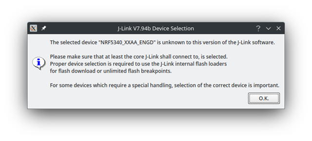

Update:
I realized that I can use nRF RTT Terminal and when I connect with it, I get:
and this on the TERMINAL:
SEGGER J-Link V7.94b - Real time terminal output
SEGGER J-Link (unknown) V1.0, SN=1050777042
Process: JLinkExe
I then select nRF5340_xxAA_APPfrom the target selector and that's basically it, the terminal is not responsive but the LED by the iMCU is flashing really rapidly now.
