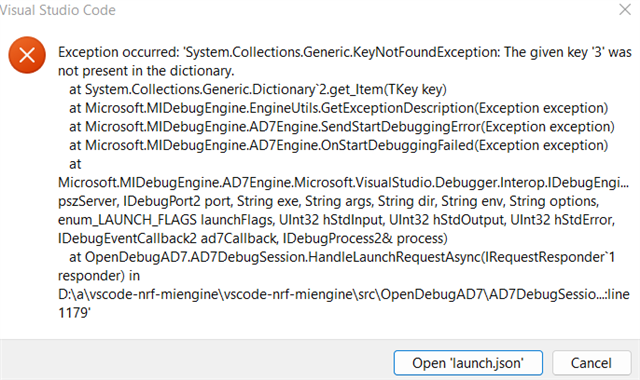

Debug option in nRF connect extension(v2023.11.301) in vscode is unable to start a debug session
I have recently updated my nrf connect extension in vscode from 2023.2.56 to v2023.11.301.
The debug option in the latest nRF connect extension is not able to start a new debug session.
A typlical debug action involves flashing the selected build and start the threads i understand. But right after flashing, vscode throws an error as below:
Im assuming my launch.json has something to do with it, below is how it looks like:

When i was running the older version 2023.2.56, it would never create a problem with the same launch.json. The debug console would look like:

    I reverted and built a default launch.json and tried, but resulted in same error. This is how the default launch.json and the error look like:

    Error window:
    To build the default lauch.json I used this link, where it said to use nrf-connect as default debug type

  • Our VS Code developers are back from vacation next week. I will ask them about this when they are back.
  • Hi Vamsi,
    Can you provide support information from the VS Code extension?
    1. Open the command palette (Ctrl + Shift + P or View > Command Palette).
    2. Write "nRF Connect: Generate support information" and press enter.
    3. Copy the entire support information output.
    4. Upload it here using Insert > Code or upload a .txt file with Insert > Image/video/file.
    Make sure to remove confidential information you do not want to be shared in a public case.

  • Hi Vamsi,
    Thank you! I have provided the support information to the developers. I will let you know when I get a response.
    Marte
  • Hi Vamsi,
    The developers are aware of the issue. The workaround for now is to downgrade to v2023.11.24.
    Marte
