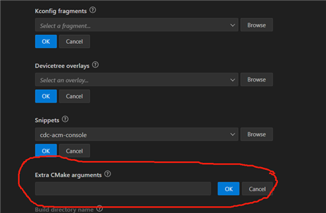

I have an nRF5340 and am trying to build the ZSWatch-Zephyr Smartwatch sample for it in VS Code with the nRF Connect extension pack. I've created a new application from the sample and have added a build configuration that looks like so:
I've selected the right target, optimized for debugging, and enabled sysbuild. I have not changed any of the sample files. When I try to build this, I get:

Any thoughts on why the unmodified sample won't build?
  • Hi
    You need to upload the full build log here for us to say anything about what exactly is wrong. There should be a message of what line throws the error in your sample.
    Simon

    Focus in this part of the error log:
    zkwei said:
    c:/ncs/v2.5.0/toolchains/c57af46cb7/opt/zephyr-sdk/arm-zephyr-eabi/bin/../lib/gcc/arm-zephyr-eabi/12.2.0/../../../../arm-zephyr-eabi/bin/ld.bfd.exe: F:\ZSwatch\ZSWatch-main\app\build/../src/applications/2048/game_2048_ui.c:35: undefined reference to `lv_100ask_2048_get_score'
    FATAL ERROR: command exited with status 1: 'C:\ncs\V2.5.0\toolchains\c57af46cb7\opt\bin\cmake.EXE' --build 'f:\ZSwatch\ZSWatch-main\app\build'
    It says fairly clearly that the file that is having issue is a file in the ZSWatch, under the source code for the 2048 game application. There is a function named lv_100ask_2048_get_score() that is undefined.
    The function name once again heavily suggests that it is a function in the project itself.
    Investigating the ZSWatch project source code, we find that this function is most likely defined in the file named lv_100ask_2048.h, which is not in the ZSWatch project directly. However, we also see that the ZSWatch project has a git submodule here referring to a 2048_lib repository.
    Follow the link to the 2048_lib repository, we again find the lv_100ask_2048.h file, and also the lv_100ask_2048.c file where the function is defined.
    Your build has not picked up the files correctly. Have you even checkout the git submodule in the first place?
