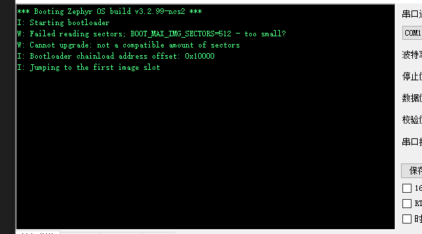

  • Right. In that case try to just set CONFIG_BOOT_MAX_IMG_SECTORS=256 for MCUboot
  • Seems to have some effect,I set 256 ,512 but still no jump to APP
    CONFIG_BOOT_MAX_IMG_SECTORS=256 or
    CONFIG_BOOT_MAX_IMG_SECTORS=512

    Can you paste all of partitions.yml into Insert->Code in a reply here?
