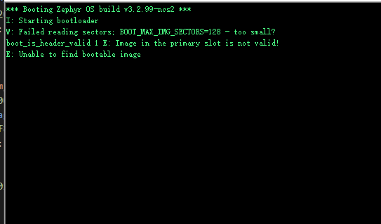

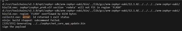

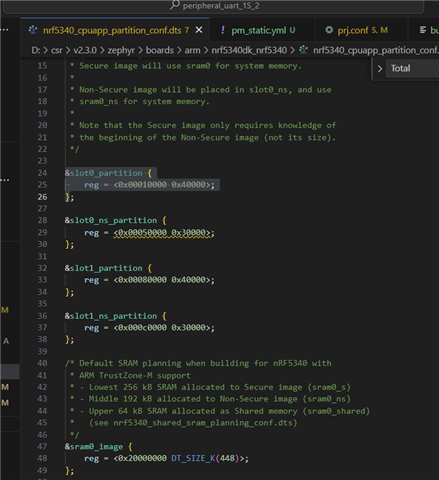

section `rodata' will not fit in region `FLASH bin/ld.exe: region `FLASH' overflowed by 6134 bytes
The project can be compiled and run normally before adding CONFIG_MCUMGR   and other configurations。

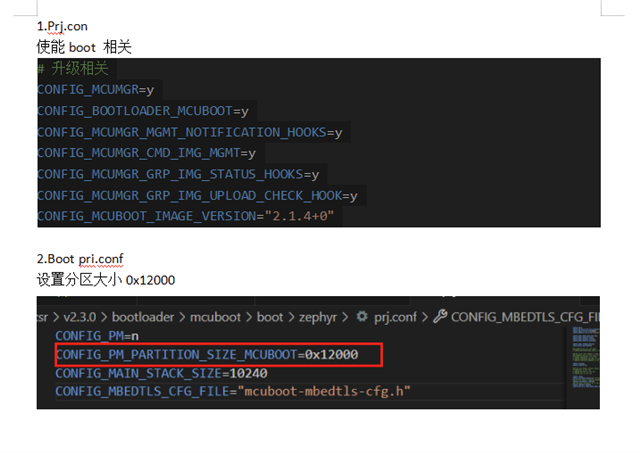

The detailed configurations added are as follows:
CONFIG_MCUMGR=y
CONFIG_BOOTLOADER_MCUBOOT=y
CONFIG_MCUMGR_MGMT_NOTIFICATION_HOOKS=y
CONFIG_MCUMGR_CMD_IMG_MGMT=y
CONFIG_MCUMGR_GRP_IMG_STATUS_HOOKS=y
CONFIG_MCUMGR_GRP_IMG_UPLOAD_CHECK_HOOK=y
CONFIG_MCUBOOT_IMAGE_VERSION="2.1.4+0"
After that, there was an error in compiling:

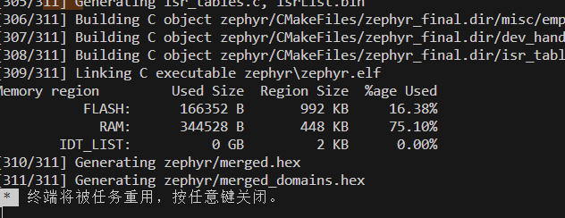

The result was successfully compiled before adding the above configuration:

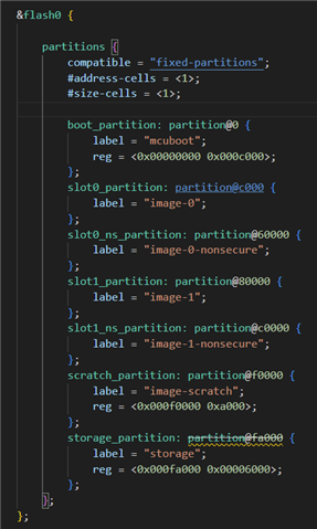

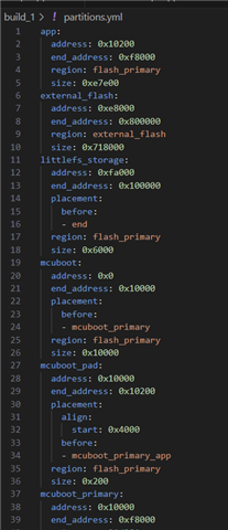

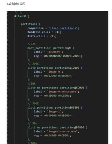

nrf5340 flash has 1M bytes, which accounts for 16.38% without boot, and it is impossible to add the boot function to exceed the size。
my  prj.con

# 升级相关
CONFIG_MCUMGR=y
