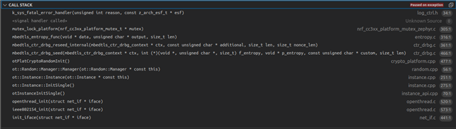

EDIT:
I put my code in debug session because it is giving me bus fault and heres the callstack:
callstack screenshot
As you can see, I am getting this error even before my main function is getting executed. Any idea why this is happening?

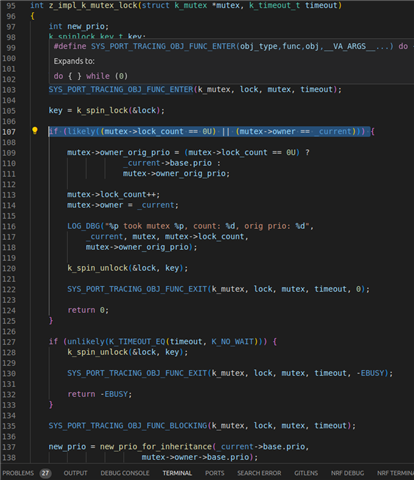

Heres the result of link register(r14/lr):
ncs/v2.5.0/zephyr/kernel/mutex.c:107
Heres the code for that location:
mutex code screenshot

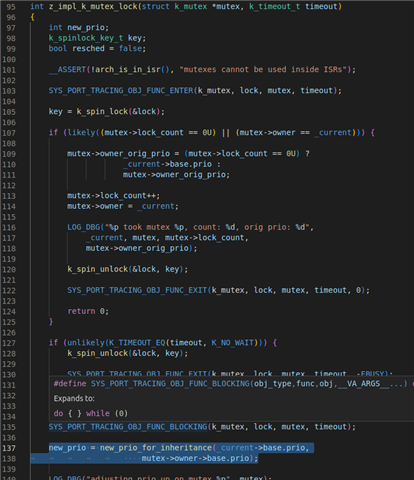

and for program counter (r15/pc):
ncs/v2.5.0/zephyr/kernel/mutex.c:137
Which has the following code on this line:
mutex pc screenshot
