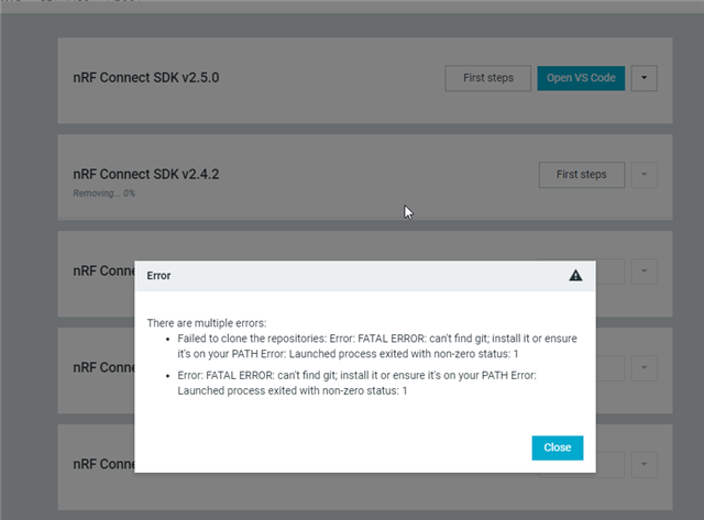

Strange installation problem with nRF Connect SDK - git not found

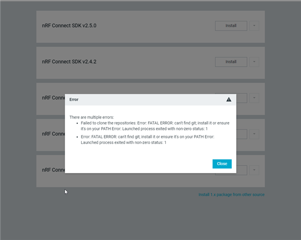

I am facing yet another strange installation problem, after  nRF Connect SDK always fails with error "not found" has been solved.
The installation worked so far and I was able to use the nRF Connect SDK without any issues.

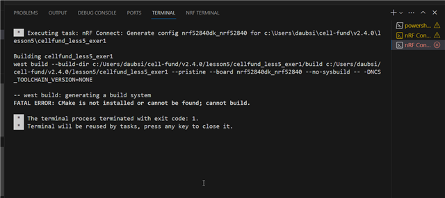

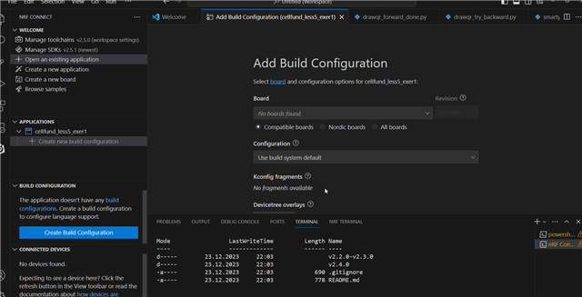

When I yesterday tried to use the setup again, I suddenly got errors like "No boards found" etc. I read up on this forum about potential issues and reinstalled the SDKs and so on. Nothing helped. I noticed that everything worked fine if I tried to build on the commandline using "west builld" in VS Code, but the UI functions did not work.
Then I tried uninstalling everything, reinstall the VS Code extensions and all of a sudden I was no longer able to install the SDK anymore given me errors like "git not found" while GIT is DEFINITELY PRESENT on the system, also in the default search path. Running git from a cmdline works fine.
So I even reinstalled GIT with the Windows installer, rebooted etc, but nothing seemed to make this problem go away.
Then I tried installing the stuff using VS Code again, but where presented the same problem

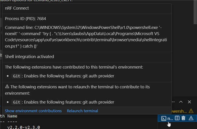

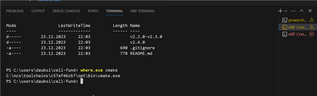

If I open a new nRF Connect terminal and issue the very same command "west init" manually there, it works:
But after the installation the extension still complains nothing is installed.

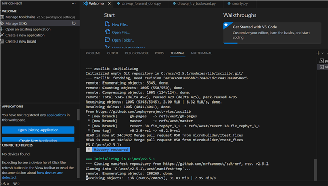

[19:08:47] nRF Command Line Tools 10.23.2 are up to date
[19:08:58] nrfutil-toolchain-manager install v2.5.0: Download toolchain
[19:09:00] nrfutil-toolchain-manager install v2.5.0: Finished, using previously downloaded file: success
[19:09:00] nrfutil-toolchain-manager install v2.5.0: Unpack toolchain
[19:09:28] nrfutil-toolchain-manager install v2.5.0: Toolchain unpacked to C:\ncs\tmp\.tmpjhd3yt: success
[19:09:28] nrfutil-toolchain-manager install v2.5.0: Install toolchain
[19:09:28] nrfutil-toolchain-manager install v2.5.0: Toolchain installed at C:\ncs\toolchains\c57af46cb7: success
[19:09:29] =========== Toolchain validation report for nRF Connect SDK Toolchain v2.5.0 ===========
No issues were detected with the toolchain.
[19:09:53] Command failed: west init -m https://github.com/nrfconnect/sdk-nrf --mr v2.5.1
FATAL ERROR: can't find git; install it or ensure it's on your PATH

What could be the reason for this?
Refering to my other post mentioned at the top: I made sure that tools like "reg.exe", "git.exe" etc. fully resolve without issued.

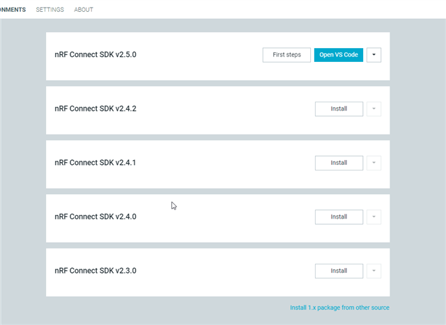

  • Hello again and sorry about the wait, I must've forgotten about this case here.
    daubsi said:
    Could you maybe tell me which commands are executed when I click on install in the ToolChain Manager UI? I'd like to investigate this further to see what could have been the reason cause I'd like to know what made it fail...
    I'll look into it, either way I am glad that it is now working for you. Though what you describe seems a bit strange. I guess the rebooting must've made it work then? Considering the new case you've created I guess it still works for you?
    daubsi said:
    I'd like to ask why you think I might have used the 32 bit edition? Where do you deduce this from? Don't think that should be the case.
    My mistake, I just quickly saw that it said  "os": "win32," in your support info.
    Elfving
  • Definitely not the first reboot... but yes, it seems it's working now as it should. The fact that also the nRF Connect for Desktop -> Toolchain Manager app showed the same problem is strange though. So was apparently not something related to the VS Code extension. I also tried opening an cmd prompt, making sure all %PATH%, etc. are properly set, git.exe can be found/resolved and then started the Desktop app from that shell and still it complained not to find git.exe...
    That's why I was interested in understanding how git.exe is called from within the app. Maybe the problem emerges from somewhere in that area.
  • Thank you for those details Elfving, this is surely helpful. I'll try to reproduce the issue and see where it is me taking.
    "Did you try installing in the terminals where...": Well, yes, because git was found in every terminal! Because it was in the normal system/user path env. I had no issue running or finding git at all. That's what's so confusing me.
    DId I understand this correctly that the commands above (nrfutil toolchain-manager launch ....) are "hidden" internally and I could not actually see them anywhere? Wonder if "procmon"  could have helped. But then again, I would not see the correlation to git anyhow.
