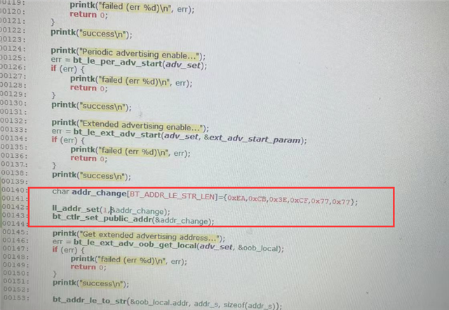

Hi guys,
I'm testing AOA function with \nRF52820\ncs2.5.0\v2.5.0\zephyr\samples\bluetooth\direction_finding_connectionless_tx example. The locator is the third part device. There is MAC address limit for scanning. So I need to set the required MAC address. Anyone knows how to change code in direction_finding_connectionless_tx example to set MAC address(For example, Change D4:26:59:9A:11:84 to 11:22:33:44:55:66)? Thanks a lot!

  • Sorry, will I get the response this week? It is a  little bit urgent.
  • Hello, and thank you for your patience.
    You can use this snippet a colleague of mine added here. I just tried it myself and got it to change the address in the zephyr sample.
    Here is the resulting modified sample code:

    /* Additions below:*/
    static void set_bt_addr(const char *addr_str, const char *type_str)
    	int err;
    	bt_addr_le_t addr;
    	err = bt_addr_le_from_str(addr_str, type_str, &addr);
    	if (err) {
    		printk("Invalid BT address (err %d)\n", err);
    	if (addr.type == BT_ADDR_LE_PUBLIC) {
    		printk("set public address\n");
    		bt_ctlr_set_public_addr(addr.a.val);
    		return;
    	} else {
    		err = bt_id_create(&addr, NULL);
    		if (err < 0) {
    			printk("Creating new ID failed (err %d)\n", err);
    /* Additions above:*/
    	char addr_s[BT_ADDR_LE_STR_LEN];
    	struct bt_le_oob oob_local;
    	int err;
    	/* Additions below: */
    	printk("Attempting to change the address\n");
    	set_bt_addr("02:02:02:02:02:02", "public");
    	/* Additions above: */

  • Yes. It works now with your this code. Thank you very much.
