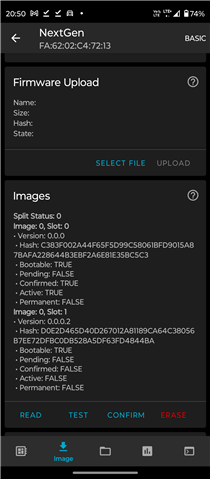

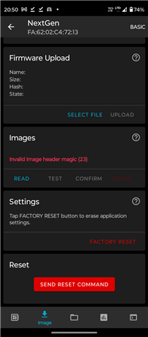

I have a BL653 module and with a lot of efforts somehow I was able to successfully create a secondary slot for mcuboot in external flash connected using SPI. Every time I try to DFU over BLE the latest FW image gets loaded in external flash which is secondary slot - slot 1. But I am unable to load the latest FW image in slot-0 or to boot the latest FW from slot-1 itself. I am using nRFDeviceManager app for my experimentation and try to upload the dfu-application.zip from build folder. When  I click TEST the RTT shows  <err> mcumgr_img_grp: Faled boot_set_next with code 3, for slot 1, with active slot 0 and confirm 0. Also the app reports error Invalid image header magic(23)

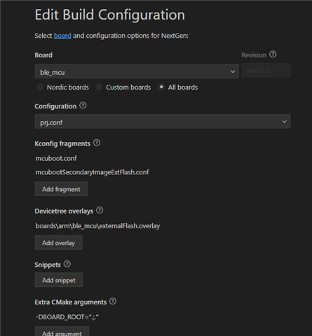

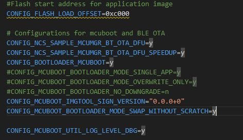

Here are the settings from mcuboot.conf file

    Does it act different without the "MOVE_WITHOUT_SWAP" configuration?
    Why do you use CONFIG_FLASH_LOAD_OFFSET? This configuration is normally not needed.
    - No I did not see any different behavior.
    - I tried to compile with CONFIG_MCUBOOT_BOOTLOADER_MODE_DIRECT_XIP mode but it gives compilation errors partition manager complains about the mcuboot secondary image in external flash so I am trying with other options.
    - I just followed this from one of the example I guess. Do you think this is the culprit?

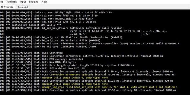

  • Do you get bootloader logs over RTT or UART from your application?
    This sometimes gives hints to what went wrong.

  • Here are the logs I get when I try to boot the latest image from external flash, I have highlighted the logs from mcuboot. I am really not sure are these the correct one that you are referring to. If there is any macro to enable boot logs please let me know.
    Indeed there is. You can enable logging in the MCUboot child image.
    See here for an example of how. Remember to put it in child_image/mcuboot.conf, as is done in the sample.

    Apparently I am not using any folder named as child image, I am just adding the .conf and .overlay files in build configuration. Is that a problem?
    That will not work.
    Multi image build configurations will detect the folder child_image and apply configurations acordingly.
    Since you do not have this, my guess to the error is that you have not configured external flash for the MCUboot child image, and therefore MCUboot can not access external flash when trying to swap the images. See the child_image folder in my external flash sample  for how to configure this
