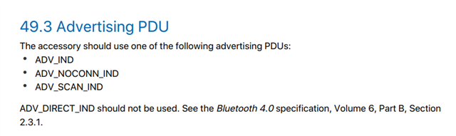

    A peripheral can perform Directed Advertising to a bonded peer. If the central is scanning and detects that advertisement, it can send a connection establishment packet, or a Scan Request. Upon receiving those packets, the peripheral would know the central is available.
    There are a few points to notice:
    • The central is completely free to choose what to do when it receives the Directed Advertising packet.
      • I didn't have the chance to look up the Bluetooth Specification thoroughly, so I am not sure if there are any required behavior for a central device upon receiving a Directed Advertising packet.
      • Note that Apple's Accessory Design Guidelines recommend against the use of Directed Advertising. They don't explain and I am not sure why.
        What this means is that we cannot be sure that Apple devices will automatically connect to Directed Advertisements.
    • The central has to be scanning.
