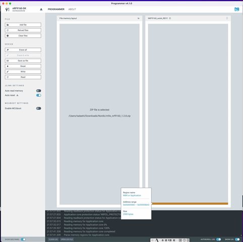

Recently I obtained an old development kit of nRF9160 (Board:PCA10090 0.8.5 2019.7, nRF9160:BAA-E2.1.8 12149). When starting to use it,
I followed the instructions in Quick Start v0.2.0 for nRF Connect for Desktop v4.3.0 and the modem firmware version is now v1.3.5.
An error was displayed on Verify, so I checked the firmware download page and found the following statement, so I would like to downgrade the firmware on my nRF9160 modem.
However, unfortunately, when I read a previous article, it was written that the modem firmware cannot be downgraded. Is there a way to downgrade the modem firmware on an older nRF9160 to version 1.2.8 or lower?
Before applying this version:
Note that this modem firmware is targeted nRF9160 SiP Revision 2
It can be used for nRF9160 SiP Revision 1, but only for testing and development
It cannot be used for engineering samples of Revision 1 (e.g. DKs or Thingy:91 with version older than v0.9.0)
After you upgrade to MFW 1.3.x it is not recommended to downgrade to MFW 1.2.x or MFW 1.1.x.(potential file system issues)
Thanks & Best regards,
