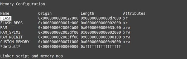

Hii,
Here i posted the ld file.In this i need page 127 to 128 for the custom partition for the internal flash write and flash read.please verify is it ok for the nrf52840 for 127 to 200 pages for the user need partition.
MEMORY
  FLASH (rx) : ORIGIN = 0x27000, LENGTH = 0xd7000
  FLASH_REGS (rx) : ORIGIN = 0xfe000, LENGTH = 0x2000
  RAM (rwx) : ORIGIN = 0x20002b00, LENGTH = 0x33c00
  RAM_SPIM3 (rwx) : ORIGIN = 0x2003df00, LENGTH = 0x2000
  RAM_NOINIT (rwx) : ORIGIN = 0x2003ff00, LENGTH = 0x100
  CUSTOM_MEMORY (rwx) : ORIGIN = 0x7F000, LENGTH = 0x49000

    Does this compile properly and show that .user_flash_data is indeed located in that offset in your _build/*.map file? This does not look like accepted syntax.
    If you need a section at a specific address offset, then I would recommend that you declare that section with its expected offset/size. You should also explicitly state to the linker that it should keep the region:
    KEEP(*(.user_flash_data*))

    The code always rebooting after the below partitioning..is there any mistake in partitioning ?Is there any modification in the softdevice part ?is there any need of modification?below given the partitioning
    MEMORY

    Your memory regions "FLASH" and "CUSTOM_MEMORY" overlap. You must align the length of "FLASH" to ensure it does not overlap with "CUSTOM_MEMORY" region.
    Håkon
