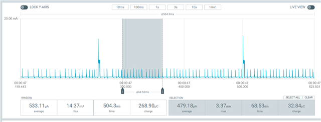

Im using the pwm led example in the connect sdk and tried few changed according to our requirements
The PWM works fine, but the current consumption during the OFF cycle is upto 470uA
Is this an expected behaviour?? Is this because of the clock used for PWM??
When i clear or turn off the PWM, i can able to see 3uA sleep current
There was an example "low-power pwm" only in nrf5SDK, is there any similar example in ncs??
or is there any other way to reduce the power consumption of the PWM led??
Thanks!
    The idle current suggests that the HF clock is not being released during idle. Have you disabled logging over UART by building the project with CONFIG_SERIAL=n? If not, the clock will be kept active by the UARTE peripheral.

  • The idle current suggests that the HF clock is not being released during idle. Have you disabled logging over UART by building the project with CONFIG_SERIAL=n? If not, the clock will be kept active by the UARTE peripheral.
    Yes i have done that and also set status = "disabled" in overlay too and able to achieve 3uA when pwm is set to 0 ( pwm is turned off)
    This confirms that you are seeing the PWM active current then. The PWM LED sample runs through various sequences in the run_led_test(), some of which will turn off the PWM, and others that keep it on.
