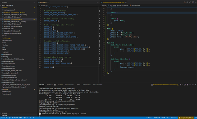

  • Hello Timothy,
    I started with the Asset Tracker V2 sample from NCS 2.5.0, and I modified prj.conf to add the config for i2c and then I edited the overlay file as shown below. I am enabling only i2c2 as you have asked and also I am using pin 30 and 31. (You can see both files in the image below)
    Compilation was successful without any issue. Copying below the content which I updated in the overlay: We are enabling i2c2 and using Pinctrl to define the pins for data and clock.
    &i2c2 {
    	status = "okay";
    	pinctrl-0 = <&i2c2_default>;
    	pinctrl-1 = <&i2c2_sleep>;
    &pinctrl {
    	i2c2_default: i2c2_default {
    		group1 {
    				psels = <NRF_PSEL(TWIM_SDA, 0, 30)>,
    						<NRF_PSEL(TWIM_SCL, 0, 31)>;
    	i2c2_sleep: i2c2_sleep {
    		group1 {
    				low-power-enable;
    /Regards, Naeem

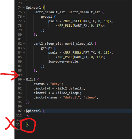

  • I have attached my overlay file. I must be adding your code in the wrong place. I copied it and pasted it inside the existing overlay file. I have also added code for UART2 in there needed for BLE operation. what am I doing wrong?
    I see the following errors when I try to compile.
    -- Found BOARD.dts: C:/Nordic1/v2.5.0/zephyr/boards/arm/nrf9160dk_nrf9160/nrf9160dk_nrf9160_ns.dts
    -- Found devicetree overlay: C:/Nordic1/v2.5.0/zephyr/boards/arm/nrf9160dk_nrf9160/nrf9160dk_nrf9160_ns_0_14_0.overlay
    -- Found devicetree overlay: C:/Nordic1/test_n160/asset_tracker_v2/boards/nrf9160dk_nrf9160_ns.overlay
    -- Found devicetree overlay: C:/Nordic1/test_n160/asset_tracker_v2/boards/nrf9160dk_nrf9160_ns_0_14_0.overlay
    devicetree error: C:/Nordic1/test_n160/asset_tracker_v2/boards/nrf9160dk_nrf9160_ns.overlay:90 (column 1): parse error: expected node name, property name, or '}'
    2364.nrf9160dk_nrf9160_ns.overlay
