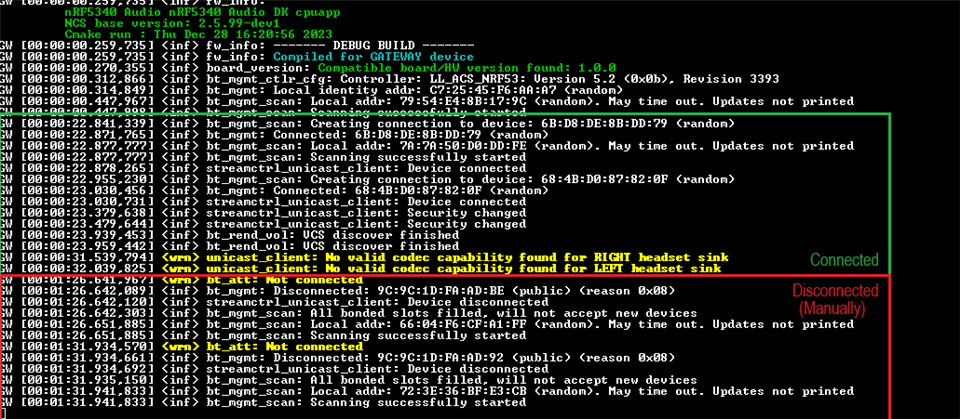

I began the process with the nRF5340_Audio project using two boards, one as a Gateway and the other as a Headset (Left). After establishing a connection between the two devices, I disconnected them and attempted to connect the Gateway to the hearing aids. Although a connection was established, I was unable to hear any audio stream.
After disconnecting the Gateway from the hearing aids, I received the following message:
After several attempts and a conversation with a Nordic representative, I learned that this project does not currently support connectivity with devices other than nRF5340 Audio boards.

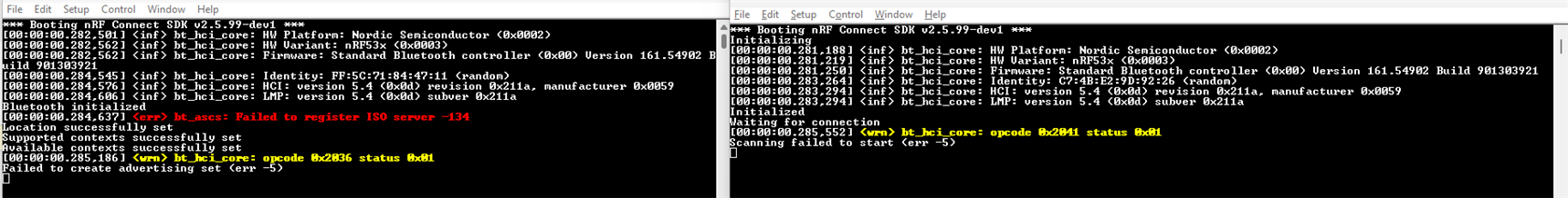

To begin, I flashed unicast_server into one board and unicast_client into the other. However, I received the following messages:
I would like to mention that I did not modify the code, and it was flashed as a standard sample of the Nordic SDK.
I have two questions:
1. Why does this standard example fail when I try to connect between the two devices? (First, I would like to connect the two boards, and afterward, I would like to connect one board to the hearing aids)
2. In the hap_ha sample, I see a mention of support for CODEC LC3, but I do not see any implementation for LC3 inside the code. Is it possible to configure LC3 inside the sample easily?

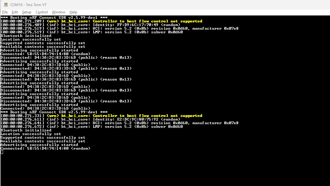

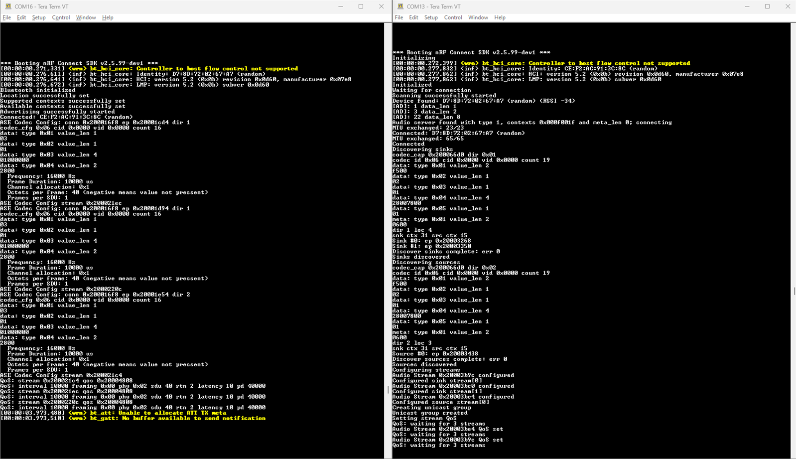

    I took pictures of the logs:
    Unicast Server - Unicast Client
    Unicast Server - Google Pixel 7 Pro
    Unicast Client - Starkey HA
    Please help me what to do next. Thank you so much.
    Regarding your initial problem with connection to the hearing-aid, I had a discussion with our developers. Here are their observations:
    - gateway connects to the headsets
    - before gateway finishes discovery, headset is turned off. VCS discovery has been finished, but PACS discovery has not yet been finished
    - scanning and connecting to the hearing-aid fails
    Once the gateway connects and bonds with headsets, gateway accepts only direct advertising from the bonded headset and it will not scan and connect to new device using ordinary ADV. You can refer to the relevant code here. There is a possibility to increase maximum number of paired devices in Kconfig.defaults.

    Regarding your remark about that the gateway accepts only direct advertising from the bonded headset and it will not scan and connect to new device , Pls note that we erase the connection between the gateway and headset before connecting the gateway to the hearing aid. it seems that there is a connection but codec capabilities is not valid.
    Pls advice how to proceed.

    Regarding unicast_client sample, you could try to add CONFIG_BT_BUF_ACL_TX_COUNT=4 in its prj.conf to make it work without errors. However, as this is upstream Zephyr sample, it does not include any HW codec driver and infrastructure. Therefore, it is expected for users not to hear any sound.
    Please let me know if you have any further questions.
